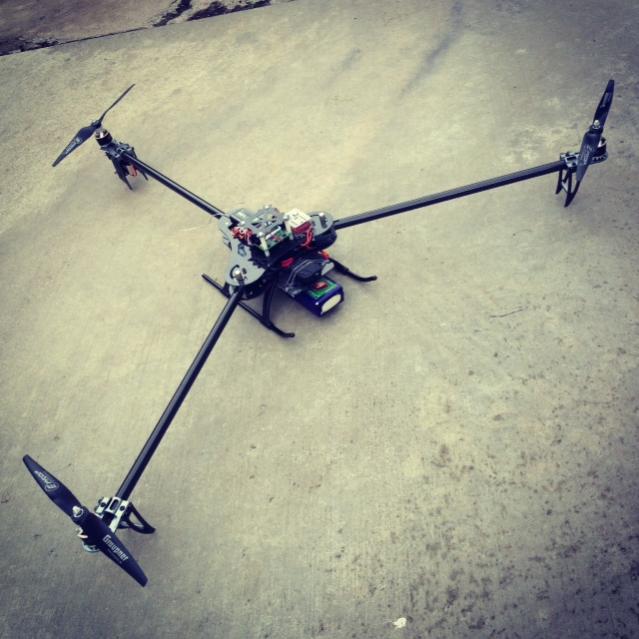

Just thought I would write a bit about my Talon and thoughts on it so far. I ordered mine along with the 380mm extended booms. I also ordered the HK "recommended" TGY-306G servo. Once the Talon was dialed in with the KK2 board and the v1.5 firmware I was immediately loving the way it flew. I'm pretty new to multi rotors, just a few months now, and several years removed from any RC stuff. I have a quad with a NAZA that is now in a TBS Diso with FPV gear, but when I just want to go out and fly the Talon is so much fun. The large booms are super stable and it just gracefully and quietly cuts through the air.
Some other additions, I added some generic 550 heli landing skids to the body. I lucked out and they are almost exactly the height of the arm landing pieces if not just a few millimeters taller. This is important because with the longer arms the body weight was causing flex when landing with the contact points being so far from the weight.
The big change for me has been replacing the ridiculous HK servo with a much much better Savox SH-0257MG. The HK unit was so far from center that I had to have serious right trim for level flight. It worked but it made my right turns really cruddy. After several weeks of that I've now had a couple of days flying with the Savox servo and damn what a difference. 0 trim on the rudder and it just flys amazing.
Some picts of an early build. I've added the getfpv bobbins to the camera mount since I've rebuilt it that have really helped reduce vibration when recording.
