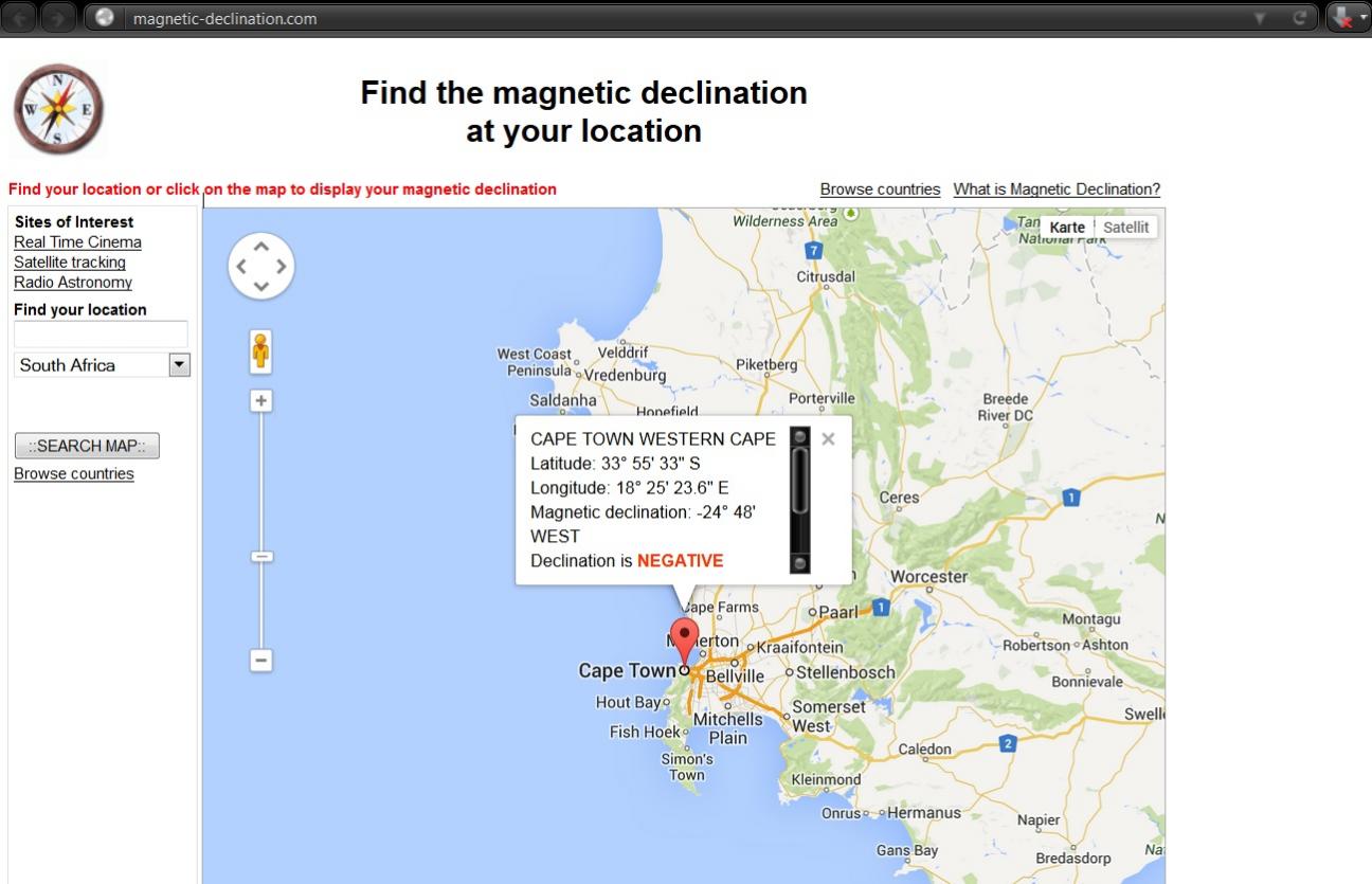

Both FC's are supposed to manage Magnetic Declination internally, but many times it just fails.....with the above methods it worked always for me. Here in Cape Town I need about -24° West, so my GPS points 24° degrees to the LEFT.....don't forget to calibrate GPS after setting to

I actually noticed this yesterday before I read this thread and I had never noticed it before. Wasn't sure what it was, but when I say your video it was exactly the same. I found on the site you listed that my location is positive 13 degrees, so adjusted the Naza puck to the right about half the distance you did in the video. I just gave it a test flight and it seems to be holding a lot better. There was some wind so it did not seem to stay completely still in the same location, but the toilet bowl effect seems to be gone. Just a little strange having the puck not pointing straight forward, but I will test it again tomorrow, hopefully there wont be any wind and see how it is.
