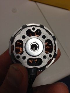

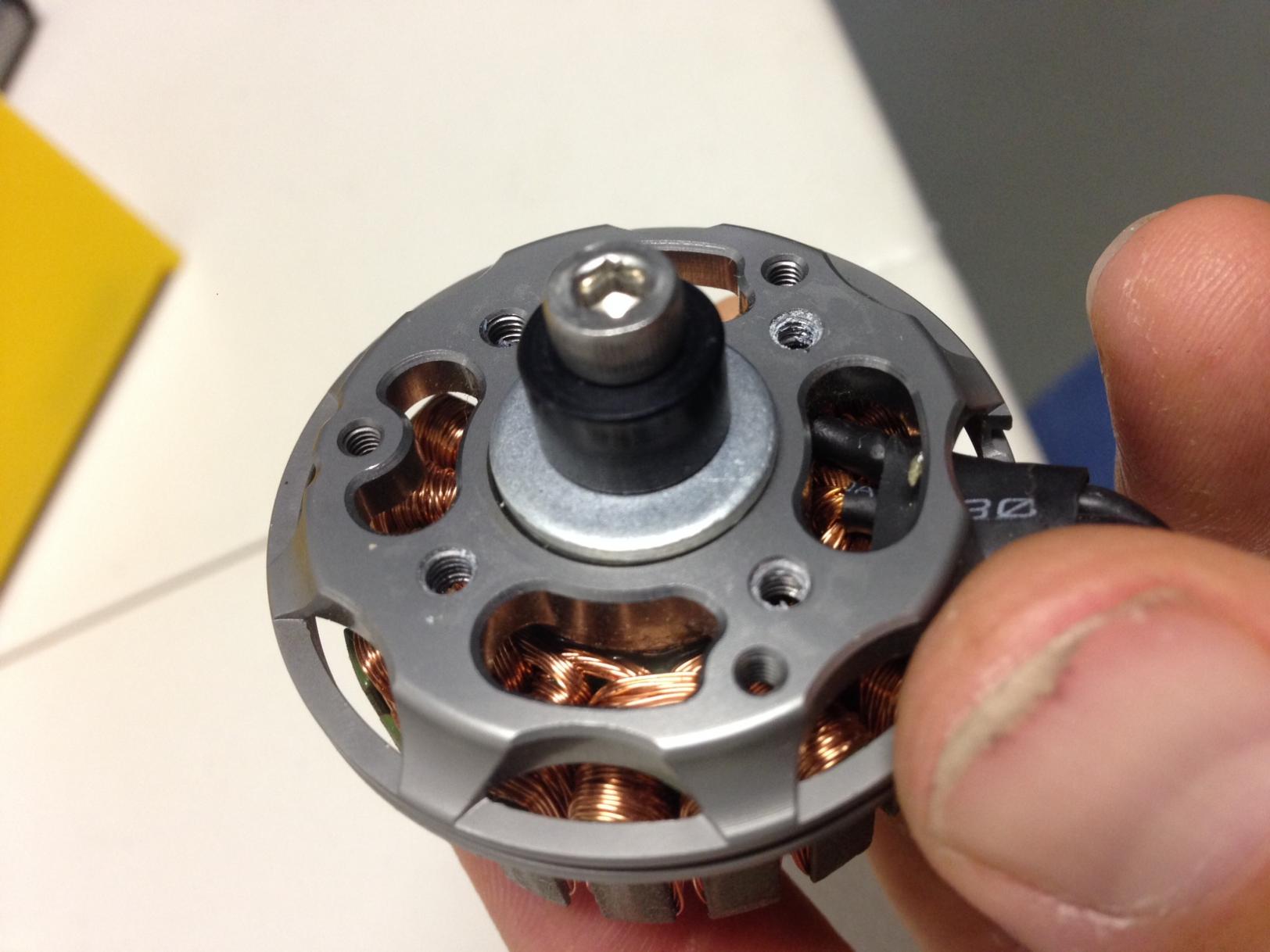

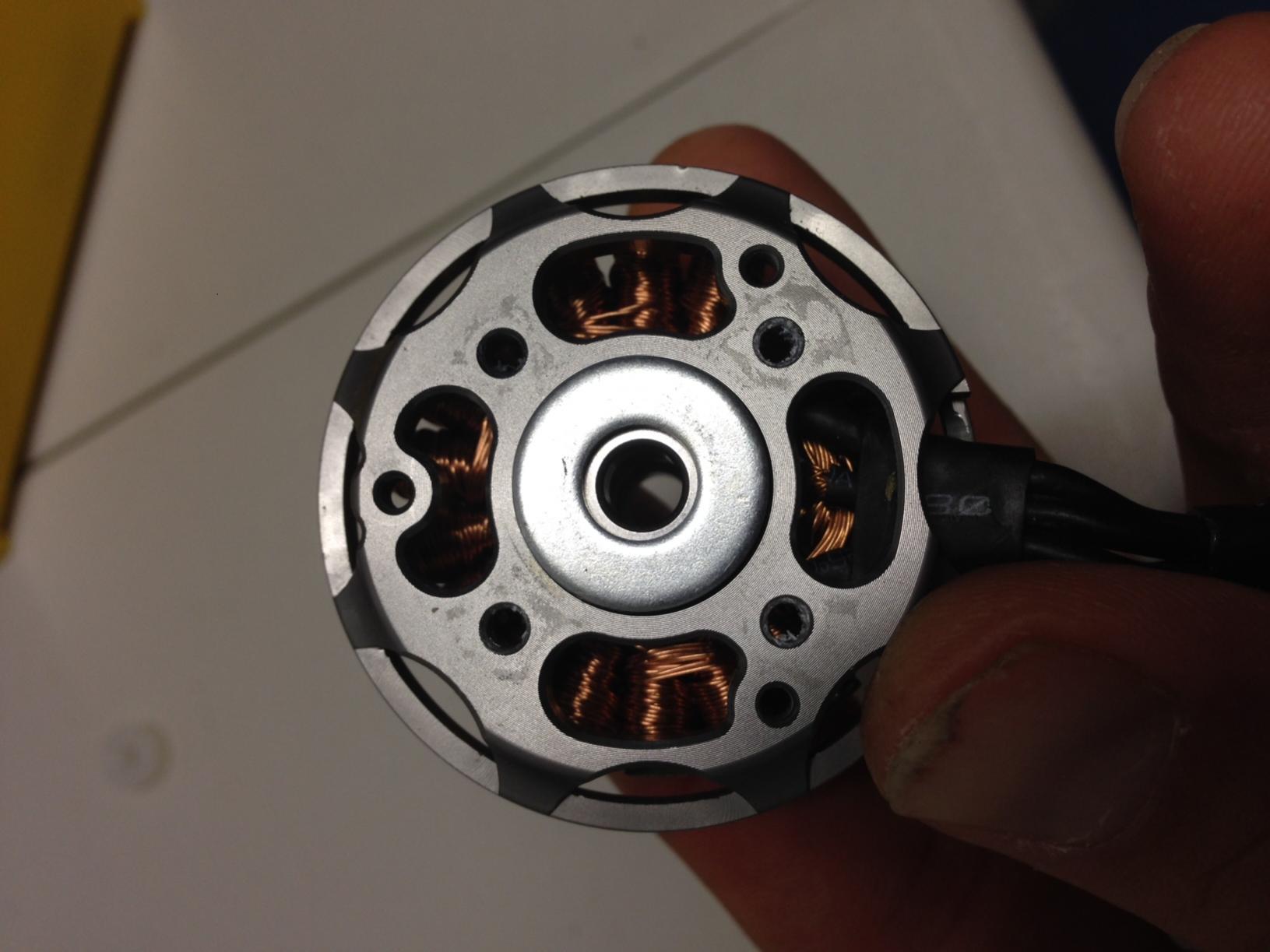

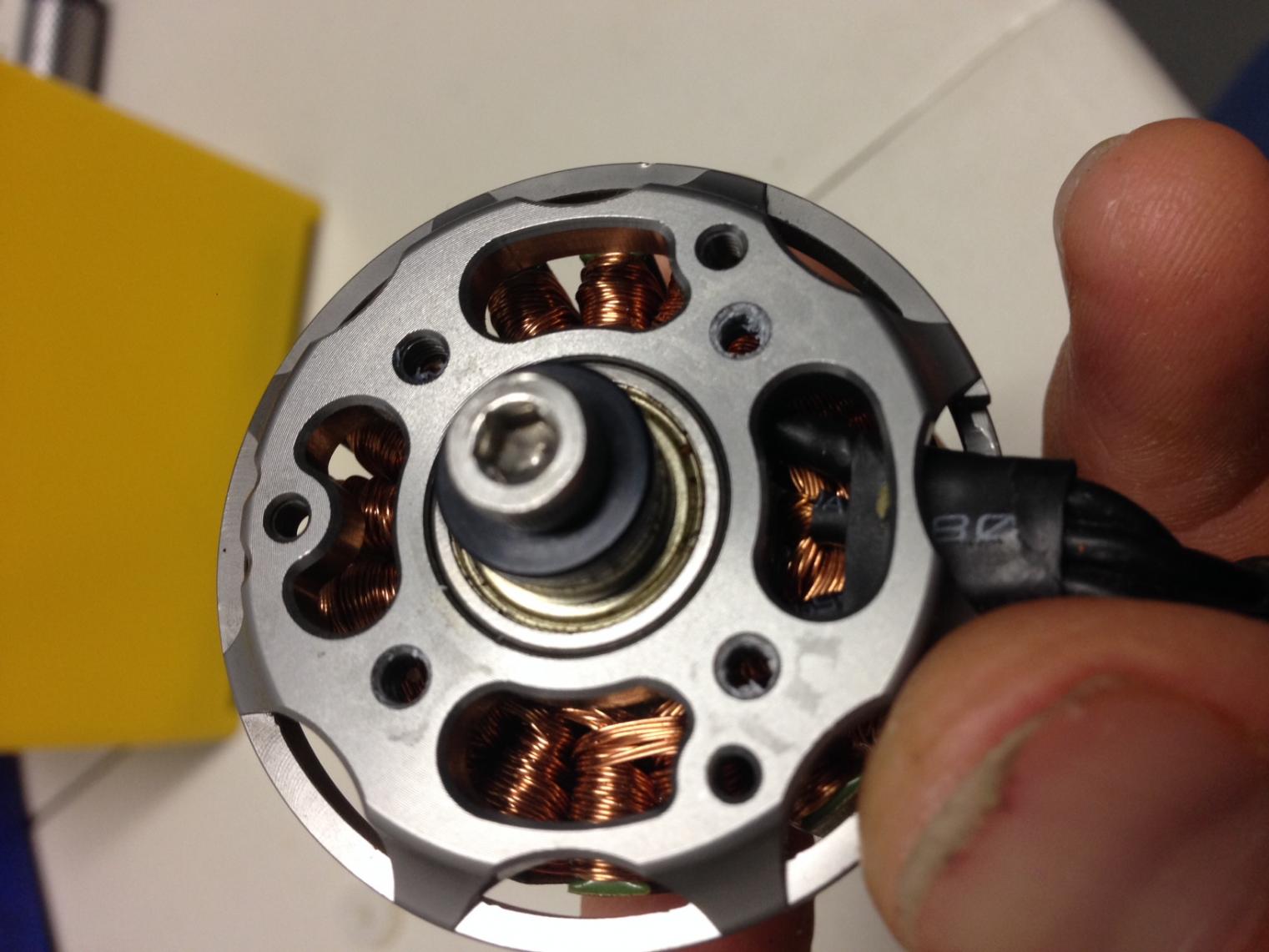

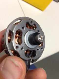

Hey guys - I need to replace bearing in a couple of my TMotor 4014s. The top and bottom bearings are different sizes. I have Bart's Bearing Press tool - but the larger bottom bearing on the TMotor is quite a bit larger than the supplied press blocks. Does anyone have some seating the larger bearing without damaging it? What about using a washer like the pic below? What did folks do before Bart's tool :)? Thanks!

I use a small bench-top vice with smooth, flat jaws. The screw/washer arrangement shown above will also work fine. Sometimes I've been able to press the bearing home just with my fingers against the outer race - depends on the tolerance. What you're trying to avoid is pressing against the inner race exclusively - pressing against the inner and outer rings simultaneously and evenly is acceptable. Bart's tool is quick and convenient when you have the right size.
