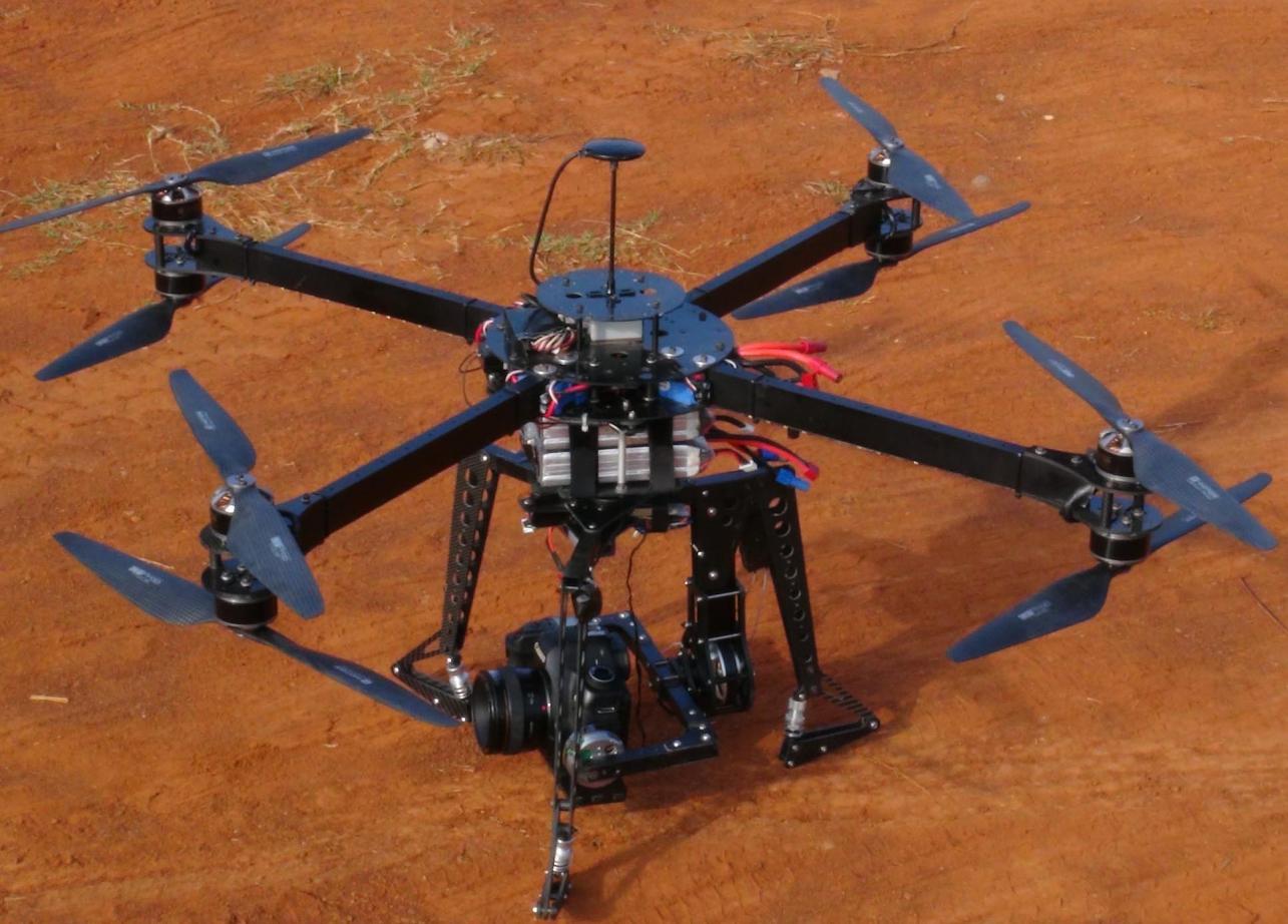

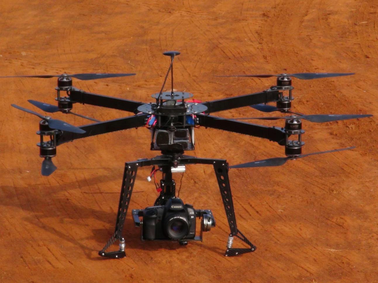

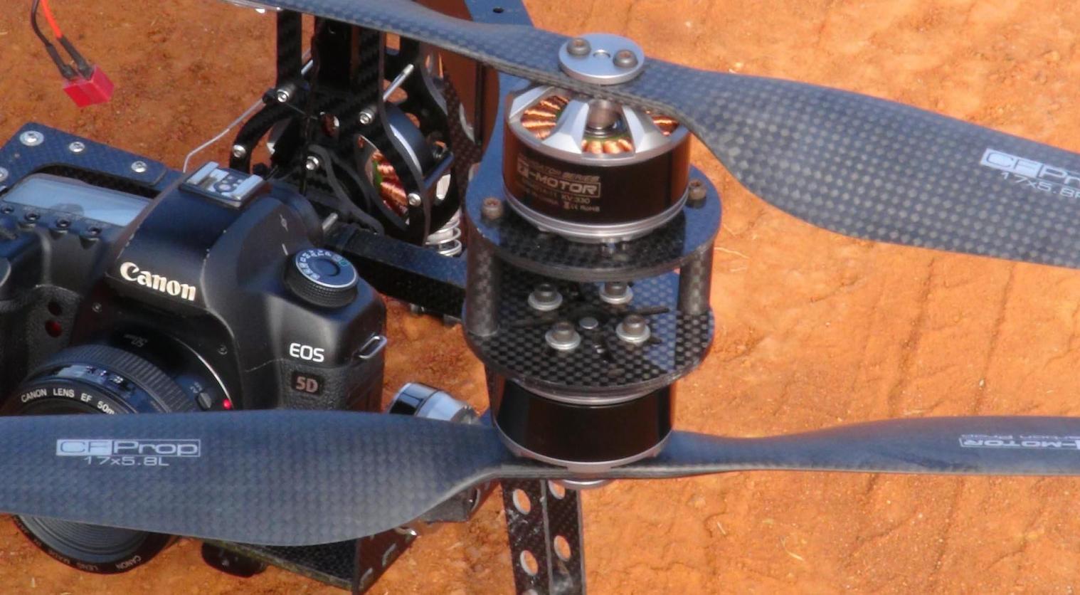

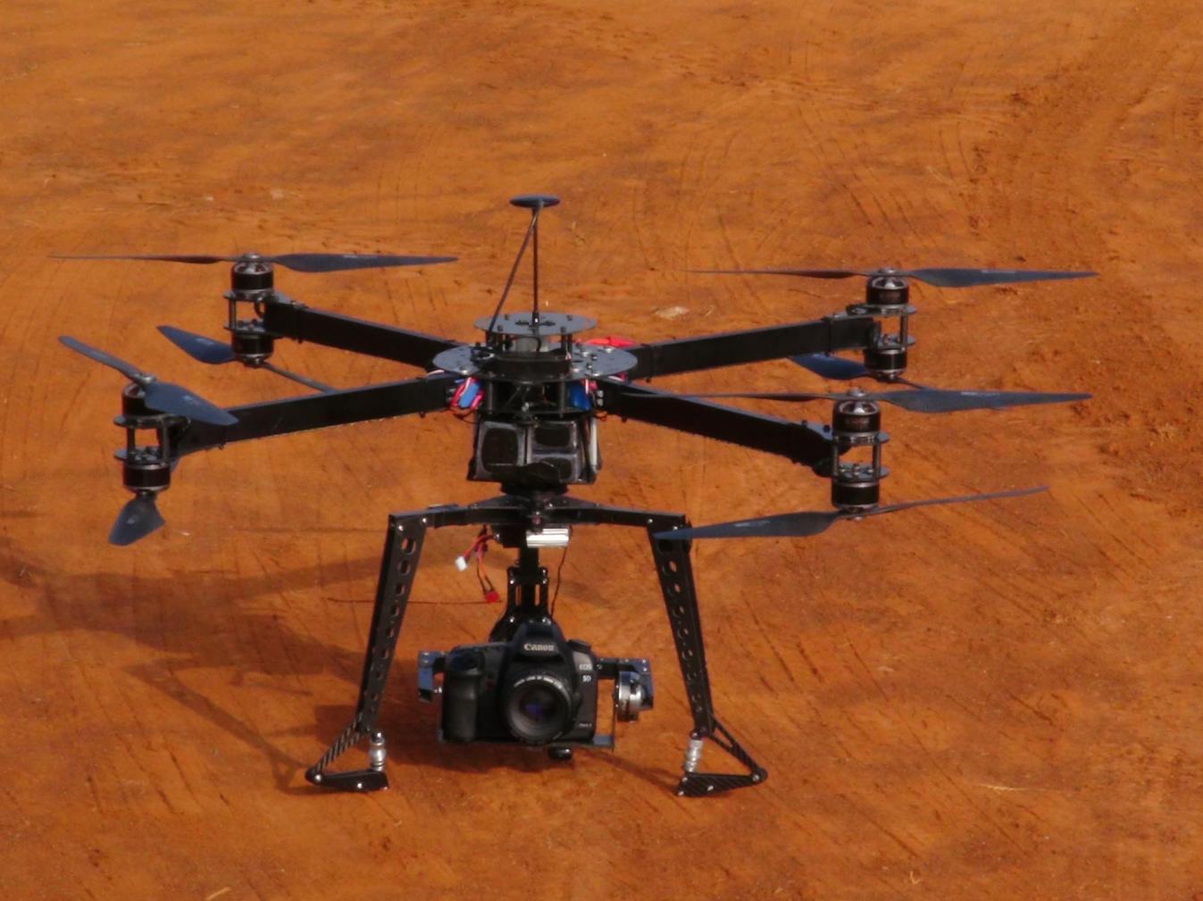

Im using TMotor 4014 340kv with TMotor prop 17X5.8 v2. Esc DYS 40A simonk V2. My X8 15.2-15.5(6.9 kg-7 kg) lbs with 5D+small fix lens & 2X 5500mah 6s 35C. I got easy 12 min or more in slow flight. Full speed flight 8 min. Landing every 12.6v
just survived 3 days assignment(6-8 flight per day), mostly in high winds condition. very stable, no wobble during decending. Just make sure you are using rigid frame & always check your motor bearing.
less wobble frame & prop = more stable RPM + more flight time.
picture shown are test flight after replacing motor bearing.
Anyone can suggest link to get radial silicon bearing?

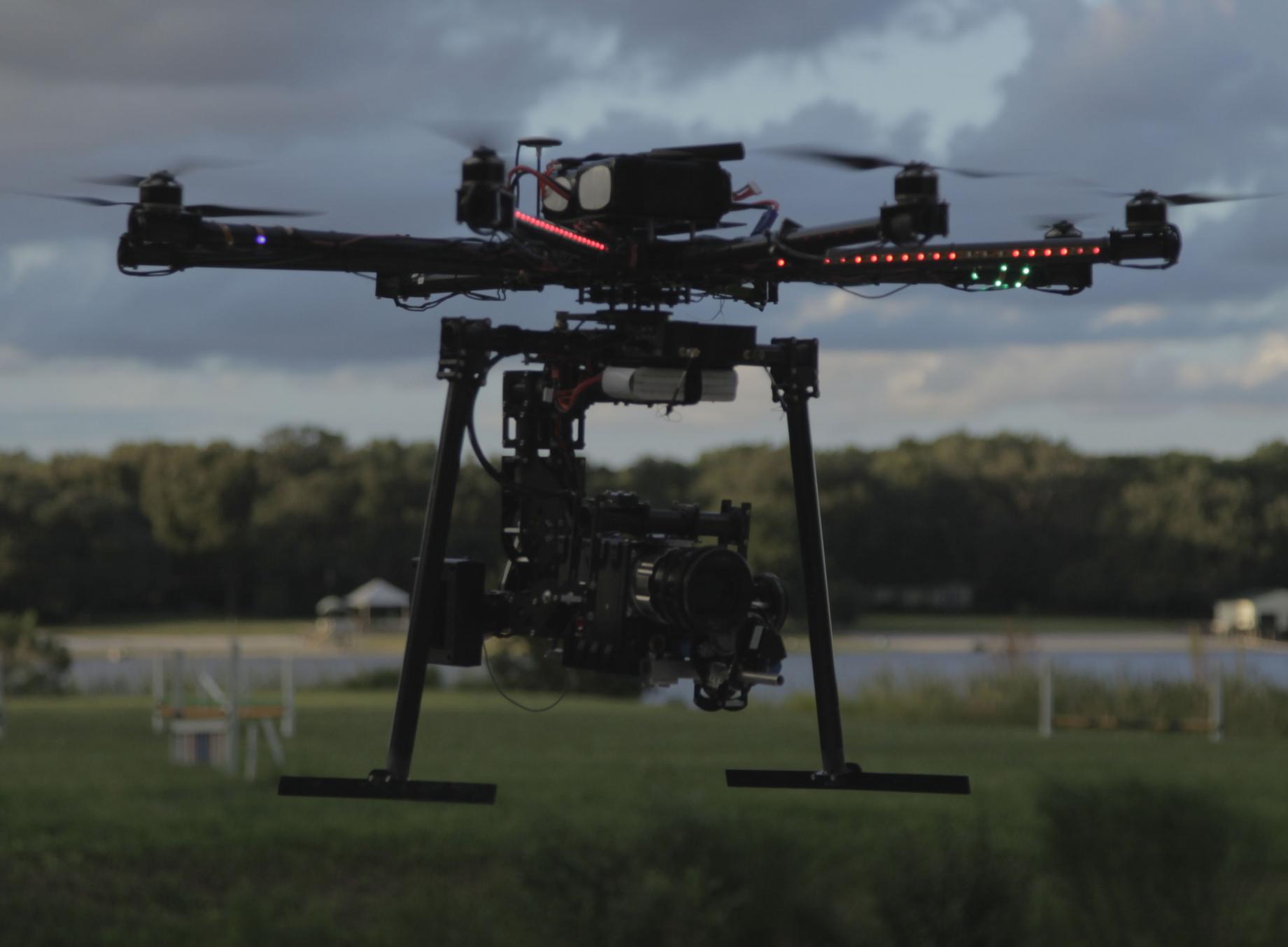

We did a heavy lift octo rig for one of our clients and with the MN4014-400 kv, the take off weight is 29lbs. red, follow focus, 3 axis gimbal. they have done over 500 flights and at least 350 of those were all over water 250 or so was over the ocean in salty conditions ( oakley pro bali ) and not to mention boat chases also. bearings are still good.

We did a heavy lift octo rig for one of our clients and with the MN4014-400 kv, the take off weight is 29lbs. red, follow focus, 3 axis gimbal. they have done over 500 flights and at least 350 of those were all over water 250 or so was over the ocean in salty conditions ( oakley pro bali ) and not to mention boat chases also. bearings are still good. View attachment 17801
