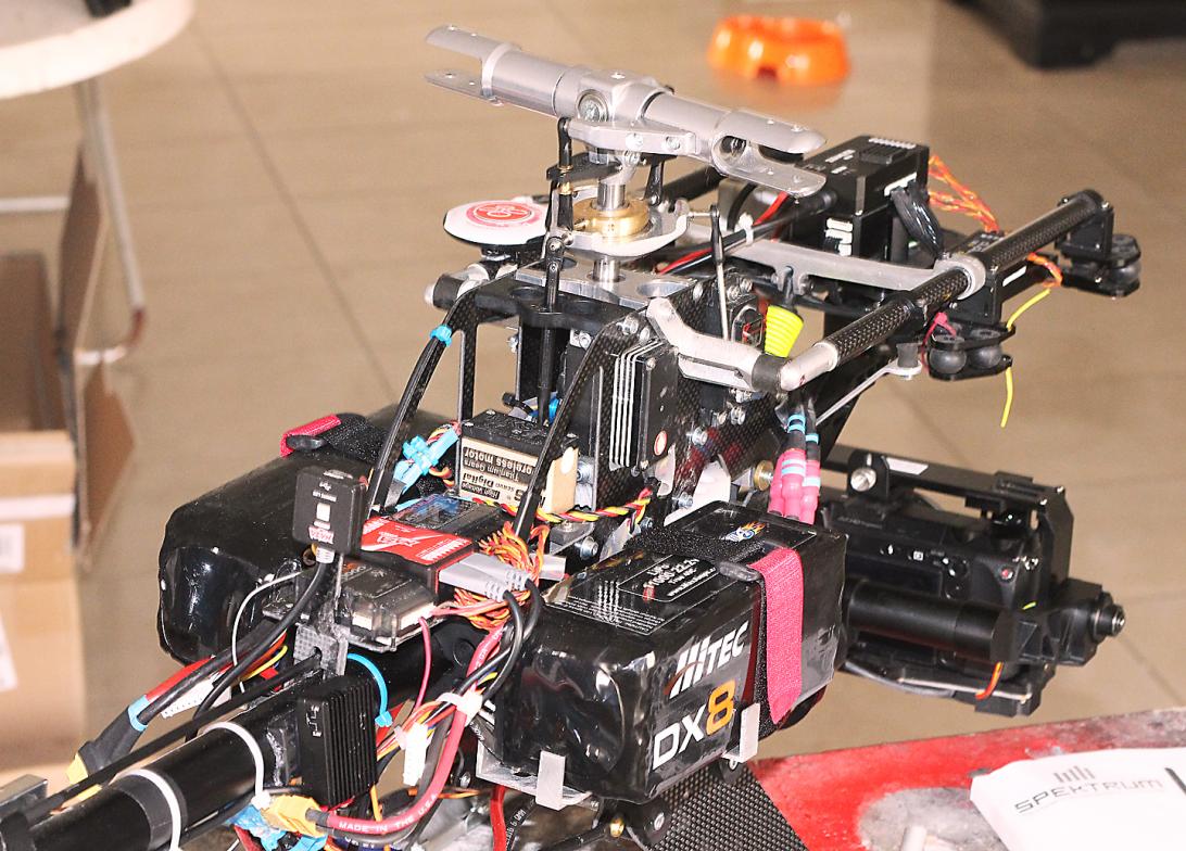

The problem is that the more you contemplate, the closer you get to one of these......View attachment 8344 7Kg auw with 22 amp battery. When you fly one of these you don't go back.

I would have serious doubts about the ability to autorotate a craft that has a central motor and relatively small blades with their inherant low inertia. With the required gearing/ belts there could be a lot of friction.
Also, as we go up in blade size, don't we just get back to the vibration problems of a SMR?

I have flown those and still have several gathering dust on the shelf. One of the big disadvantages is the inertia built up in those large carbon fiber rotor blades, takes a while to slow or stop and that could quite literally be deadly in the event something goes horribly wrong with people nearby. By comparison dropping the throttle stops the props on a multi in almost no time at all and while that doesn't eliminate the damage of a heavy object falling from a height it at least eliminates the Ginsu factor... :eek:
In a VP multi you don't need to vary the motor speed, just as with a heli you can run the motors virtually wide open and let the variable pitch mechanism take care of the thrust factor eliminating the central motor and retaining the current setup of a motor for each prop. Utilizing idle up and throttle curves just as you would for a heli you can start up with 0 degrees of pitch and as the motors come up to speed all you do is increase the pitch evenly across all 4 corners to create lift then let the flight controller take over and vary the travel of each individual servo to change the pitch/thrust as needed on each corner, effectively the same thing as changing motor speed but in this case the limiting factor is how fast the servo responds to move the mechanical bits.
As for autorotation, without that inertia that the big heli blades have it will never happen on a VP multi, there simply isn't enough mass rotating at each corner to do it unless you're talking about a supersized M/R with something like 500mm blades on each corner at which point you might as well go back to a single rotor!

Well who said the rotor blades would be light or small, and Yuri we are talking about a single motor. The typical 720 size of blade that I use on the TDR (and most other modern blades) have lead cast into the leading edge of the blade getting heavier towards the tip. As far as mechanical drag goes it is minimal because the drive shaft has a one way bearing that disengages once the inertia is greater than the drive torque. Ken if a heavy lift MR hits someone it will be just as potentially fatal as a SR Heli - But there is about a thousand times less chance of a proper heli failing in the first place. Every other factor from stability, endurance, high wind rejection lifting power etc. etc. comes down in favor of a well designed SR heli. A VP Multi could be the basis of a sound compromise that will keep the die hards happy. Vibration - what vibration.
As with a SR heli, autorotation requires at least 6 degrees of negative pitch angle so starting at 0 would be a non starter...

Yes, the weight factor in falling from a given height can be just as fatal regardless of the the number of props but an out of control 700 class heli with blades spinning at 2000 to 3000 RPM isn't going to just stop those blades instantaneously, they're going to keep spinning until the come in contact with something, hopefully it won't be part of someones body. There is far greater potential for a large heli to be lethal at low altitudes than there is with an MR.
As far as 0 degrees of pitch go, setup as any 3D heli you get 0 degrees at mid stick, that's where you would want the pitch to be on a VP multi on motor startup, after that it can go either way into positive or negative depending on what you want to accomplish. Regardless of what amount of negative pitch you put into it, small tailrotor size blades just aren't going to autorotate well enough to be effective and the only way I could see them having any effect is on individual motors where there is minimal drag in the bearings. Add shafts or belts from 4 corners into a central motor and there's no way any small to medium size multi is going to be able to overcome the drag of all those components to autorotate. Make it big enough so that it can and you'll likely be well beyond the size of a 700 class heli which pretty much defeats the idea of a multi being more useful for close quarters and places where it's not feasible to fly an SRH safely.

Well, it's a trade secret but my TDR's run at only 900 rpm. Due to the dev. done on blade design. The tips also disintegrate before too much impact damage.
Starting up at 0 deg. would not work because your throttle needs to be at 50% at 0 deg. if you want to be able to autorotate or fly inverted. Normal start-up usually has neg. pitch as it spools up.
You can switch to a different flight mode once in the air. I have a hold switch that shuts down the motor power so I can practice auto rotations (which I do frequently). I do this for a living and I have yet to find a job that was more suited to a MR. I do many jobs that would stretch the limit of what I could safely do with a S800. I would not trust any MR over the city center above 200 feet. Visual orientation being the most common disadvantage at anything beyond 100 feet against the light. The guys I work with say the same.
