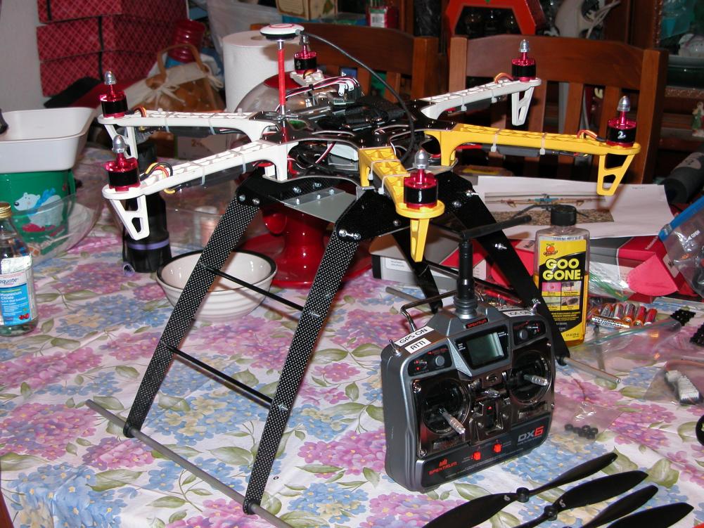

I think I may have put things back together correctly, except for attaching the camera mount which was a pure oversight on the part of an aging mind. I am still in a lot of pain, but I must battle on to reach my goal of getting airborne before I go underground or my ashes are spread across Pacific waters.
As you can see from the photo I must work from half of our dining room table. We live in a mobile home on my oldest daughter's property so we have no garage in which I may have a workbench.
I now await instructions from Ken as to exactly what to do next. There is no real hurry because I still have to balance the propellers. It will probably take me awhile to decide on the best way of doing that.
