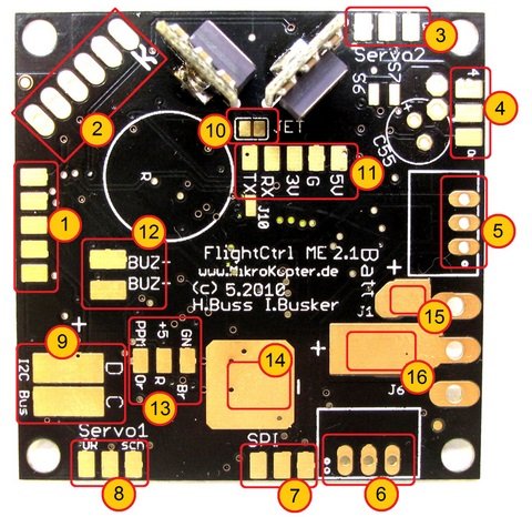

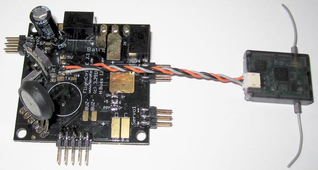

Ken have a look at this picture. I want to know where to connect my satellite(spektrum).
Is it number 11 or number 13?
I am using the Flyboard.

No. Is the 9503 with the 921 I wont use the 8000 on the MK
I will be using the divercity board
If you are going to use the diversity board you will need to move the power connection from the 3 volt to 5 volt pad, the diversity needs 5 volts to operate and it will provide the correct voltage out to the satellites.
