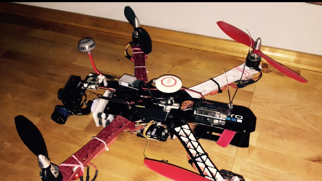

Ive built a TBS Discovery from scratch. I printed pics from the plates of the disco and sized them up in the printer % till the holes fitted the DJI legs then I cut the plates out of PCB board. I also made the Tarot 2-D a front facing gimbal with polymorph pellets that melt at 60degs and harden to desired shape. Its also got NAZA Lite with M V2 firmware flash, PMU V2 ad Mini iOSD.
It was all working a charm till I added the DR8-iiPlus and DJT frsky to my 9X. Now its all over the place. Any ideas?
