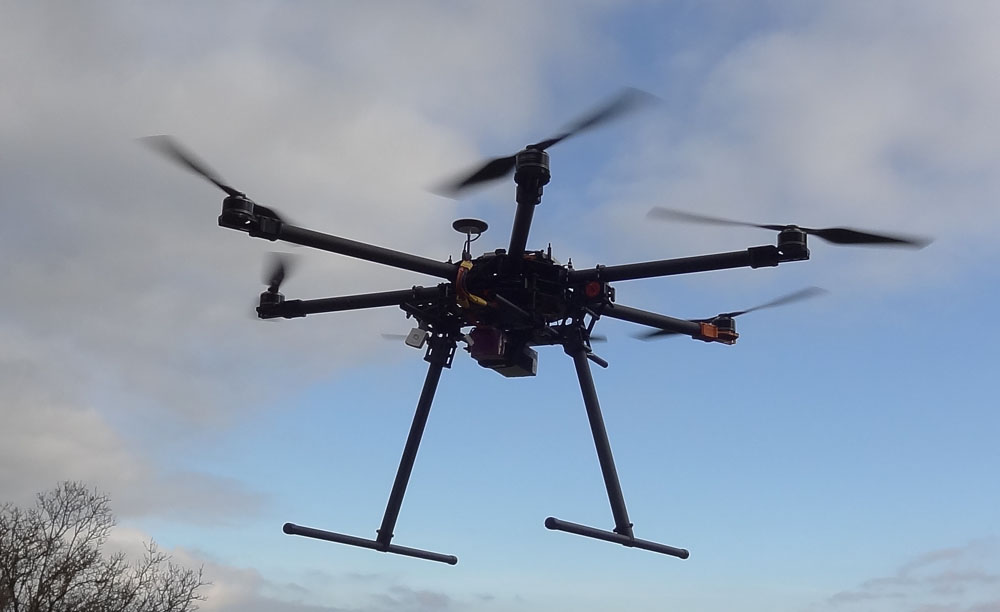

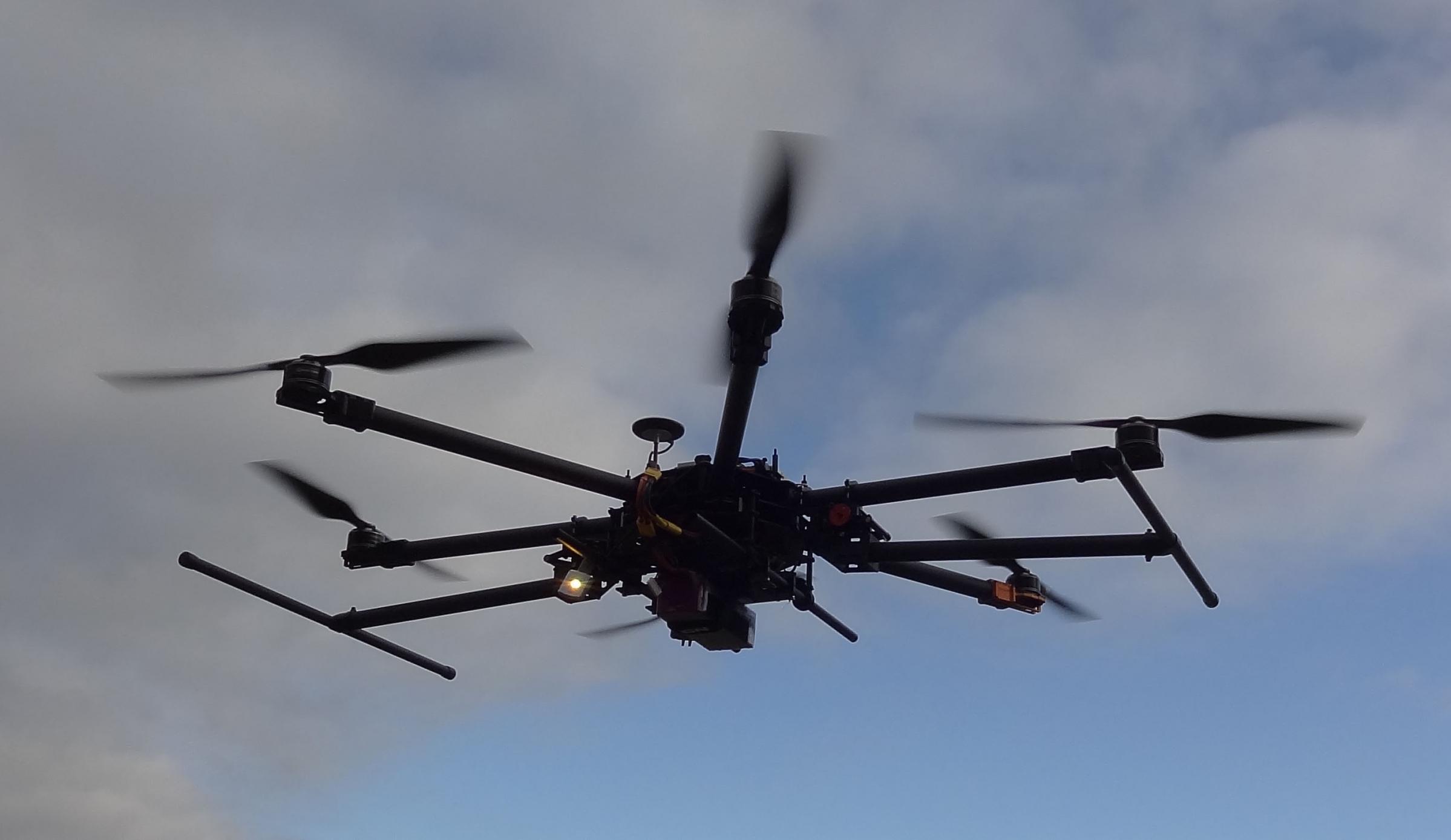

djiflyer1
View attachment 15769View attachment 15770
so, I'm almost finished.
4620g
18"
6s5000
6min 57%left
i'm sure now with the zenmuse z15 gimbal on a gh2 - i think its the best fit with the A2.
the retracts came today. I ordered from foxtech friday night - i would had gotten them yesterday - but the german dhl dude couldn't find my house .......... - otherwise fastest shipping so far !!

You do realize that this is the XAircraft threads? I.e. People would like to know how an XAircraft SuperX works on that frame. Just a thought.
Jeff
honest mistake folks....what's the cost of a frame like that with the retracts?

That looks really good, except the DJI of course... hahah j/k ;)
Curious how you were going to place your batteries once you get a gimbal on there?
Do you mean 18" props? I only have 15" for my T810... hmmm.

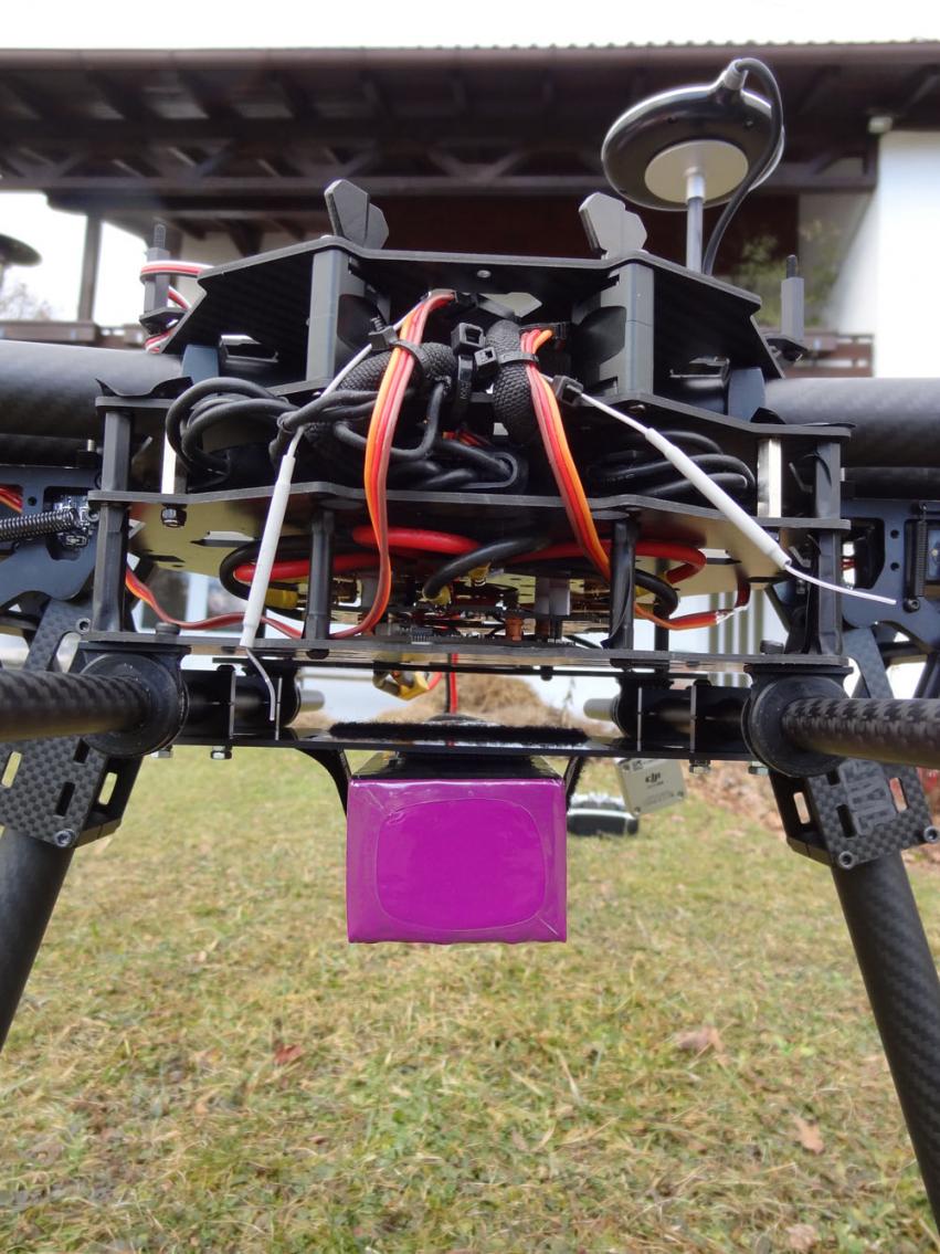

I've got about the same set-up as you. I'm using three extra small battery plates in the center to mount the IMU. Two at the very bottom where the IMU is mounted and one on top. I used two plates at the bottom to make sure it's extra sturdy.
Aerovideo
Nice setup, I was thinking of doing something similar. Although I only have 3 of the small battery trays.
I also have the gimbal rails as well as the dual battery plate like you have but for the life of me I can't figure out how one would mount two batteries on that plate as all the slots are parallel with the length of the plate. I was going to mount my EZUHF Rx on the top of the battery plate where you have your IO block and Rx. Putting the IO block on there as well is a good idea!
I was actually going to mount my ESCs under the motors on the plates provided... hmmm...
Thanks for posting the pics and sharing, I need all the help I can get :D
