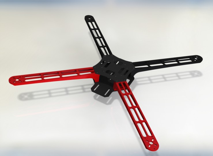

or try these .. Aluminum arms.. i love them... no vibs at all
