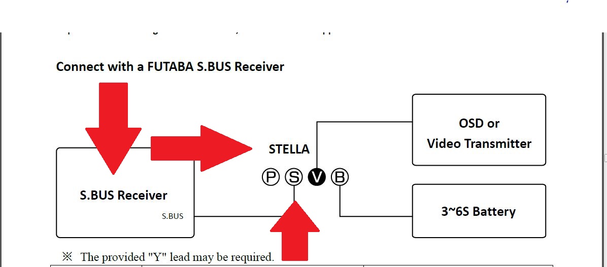

I should have the Stella this Wednesday. I looked the manual yesterday but where I am confused is that the Futaba receiver has one s-bus port which is going to the Naza. Now I need a second s-bus port for the Stella.
skquad
All you need is a y - servo cable. Plug the common end into your receiver and then over end into the naza and the other into the Stella.
From the manual you read yesterday!
I think you have misunderstood what Idahobell is having an issue with. He knows where to connect sbus to the Stella. What he doesn't seem to understand is sbus is 'bus' style connection as opposed to point-to-point as with traditional Rx channels.

I have to agree with Skquad. I solved my issue of only having one s-bus port on my receiver by purchasing a Futaba s-bus hub off eBay. Now I have three ports.
