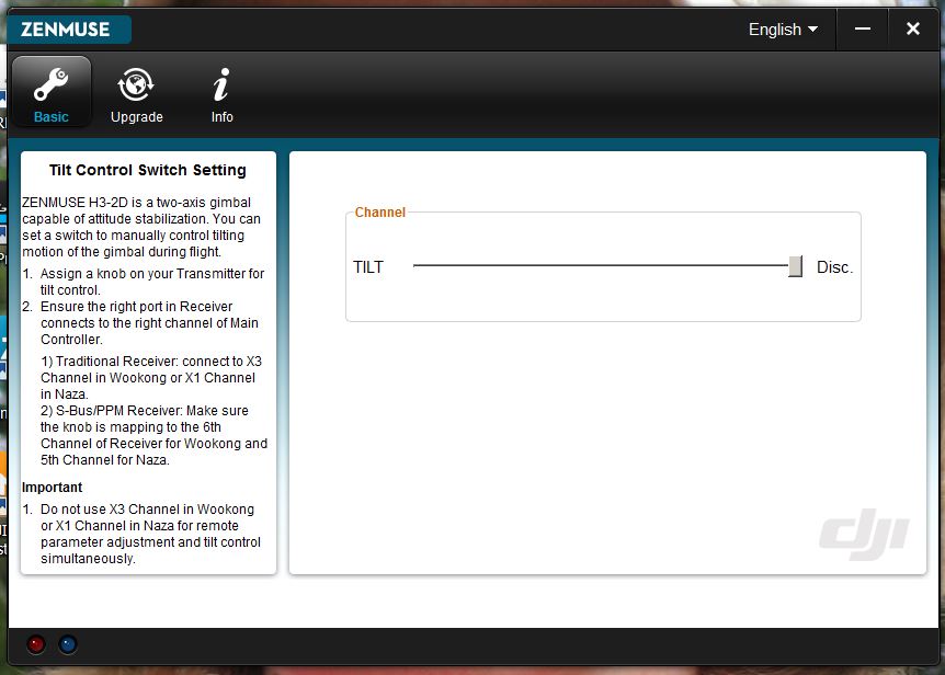

There is a separate assistant software for the gimbal:
http://www.dji.com/download/zenmuse-h3-2d-gimbal-downloads/
Install it; run it; it's mostly downloading the new driver.

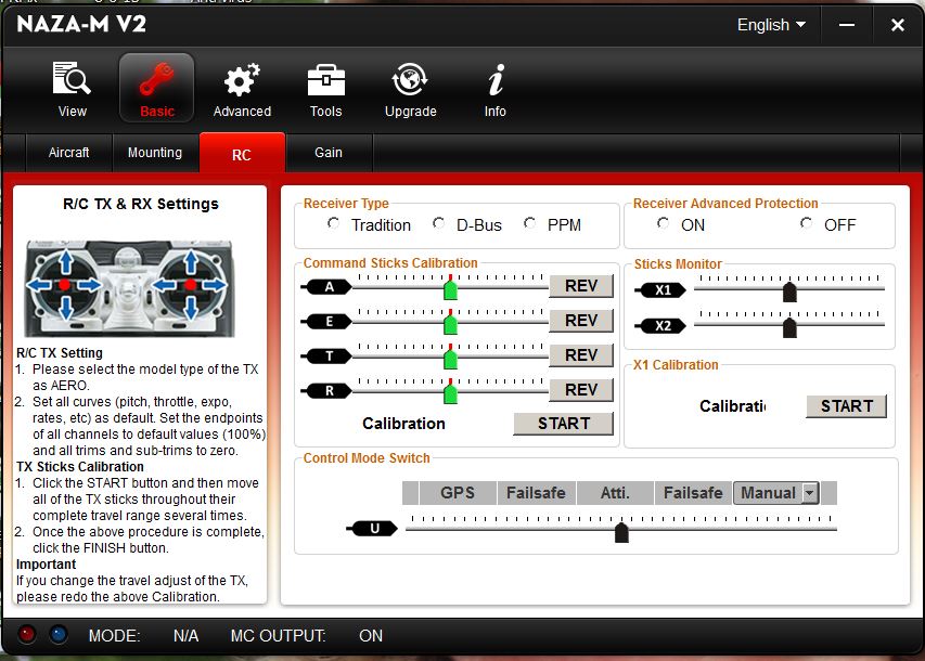

Then go back to the Naza Assistant and calibrate the x1, which was gimbal tilt on the knob with my DX9:
AT least that worked for me. Since the Naza Asst software had gimbal calibrations, I thought I was done and didn't even know there was Zenmuse Asst software, too. BTW, you'll plug into the USB on the GBU to run the Zen Asst software.

Exactly what it was as I discovered late last night - sticks monitor for me was always gray until I did what you did. THANKS! It's nice to actually pitch instead of be straight up or down :)
