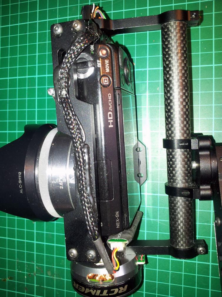

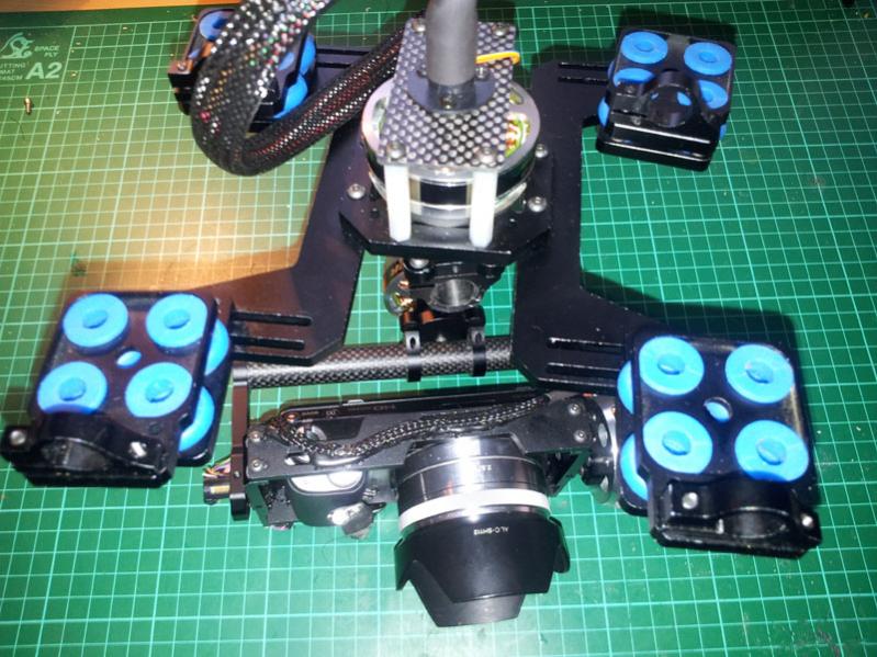

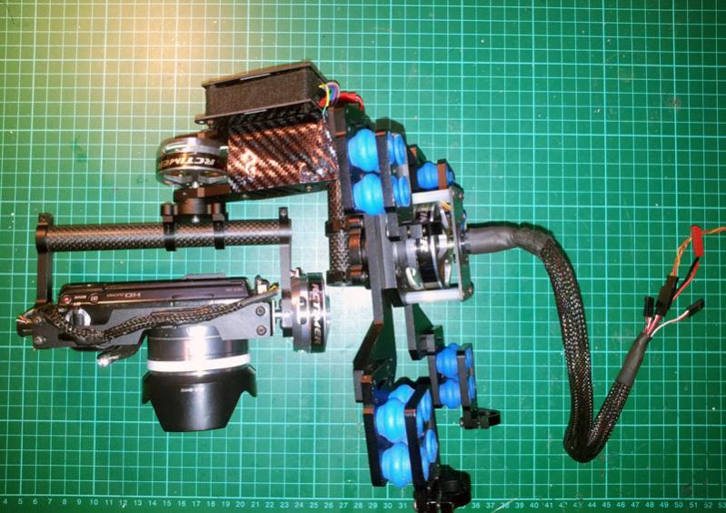

I was a lot lighter than my Zenmuse..... Zenmuse with camera is 1.65kg...bare is 1.25kg.. the Thankbuyer gimbal is mix of carbon and ali
Obviously the tilt and roll wont do 360 deg like Zen.. but Yaw will... performance will depend on how well you balance it and setup the Alexmos.... biggest pain was doing all the wiring.. HDMI converter and IR trigger etc.. could d with a few more ways on top slipper ring as well.
