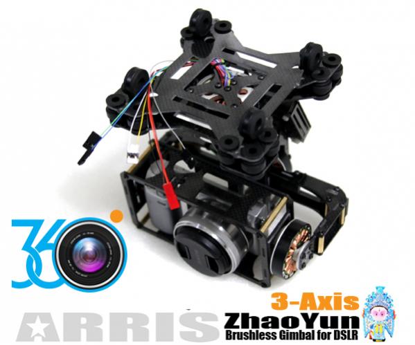

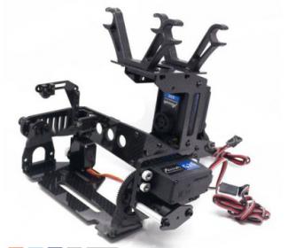

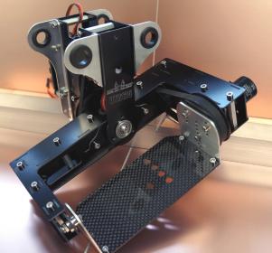

View attachment 15379 View attachment 15381 View attachment 15380
The only solution I can think of is to use a servo gimbal with an additional servo to vary the zoom. I already have an Xaircraft CF gimbal which uses a servos and gear drive but it relies on my WKM for stabilization but is fine for stills but not very stable for Video. The other is out of production but still available - the AeroXcraft VTR125 this can be stabilised by either the WKM or hoverfly gimbal board.
Has anyone ever tackled this issue and overcome it.

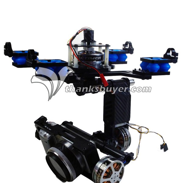

Jumpy07
I had one of these before I bought my zenmuse.. they obviously tried to copy the Zenmuse.. its was very good.. and I preferred the way the yaw worked on the Alexmos on this to my Zenmuse..
The mechanical bits were quite good.. it also had sip rings.. wiring you have to sort out yourself.. but with new 32bit Alexmos this would be a good gimbal..
It has bearings and pivots rather than relying on the motors like most cheap gimbals do.. pitch is also supported on both sides unlike the Rctmer Gimbals
http://www.thanksbuyer.com/fpv-3-ax...for-mini-slr-sony-5n-aerial-photography-27168
PS Thanksbuyer don't have a great rep.. but seem to recall seeing this somewhere else..
liske
Really? That seems cheap i comparisom if you are sayimg close to ZMuse. The item lists 300gram weight - is that correct? Seems low by the look of it. Do you recall weight?
