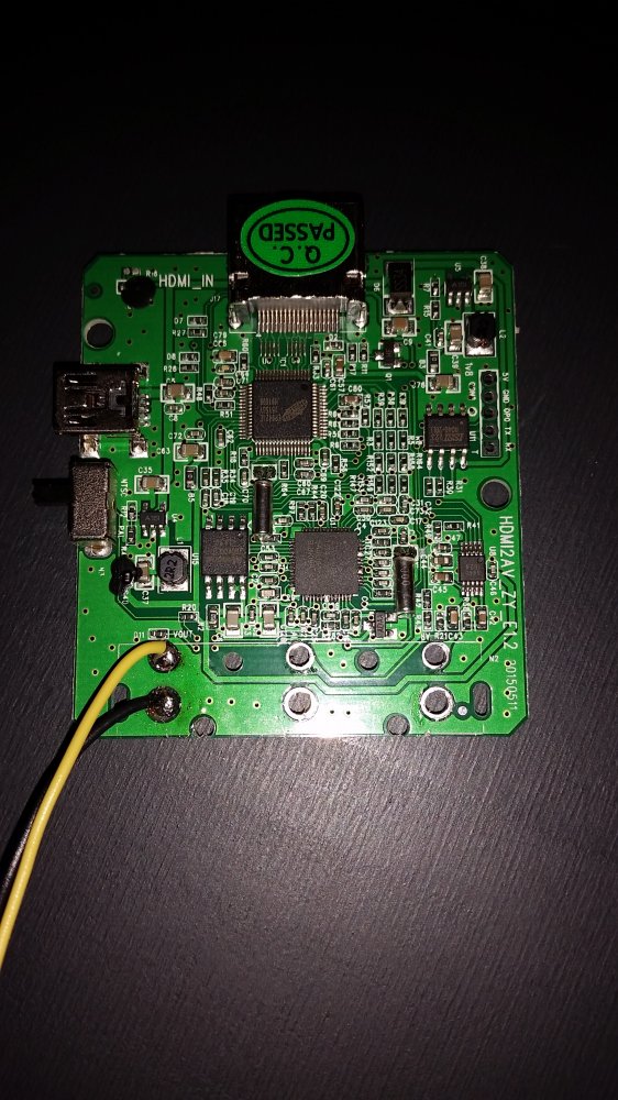

I then got the hdmi to av converter from aerialpixels. they claimed it didn't need power but I couldn't get it to work with out powering it from the mini usb. To fix that I took a mini usb from my PC, cut it and in the harness is a tiny red and black wire (5 volt and ground). I tied them to the 5V out of the video TX and the ground. Once I did that the board had power and converted the hdmi out of the camera to the composite to feed the video tx. Frankly I would but a hdmi2av converter from amazon like this http://www.amazon.com/1080P-HDMI2AV...&redirect=true&ref_=oh_aui_detailpage_o02_s00 its alot cheaper. I actually got one as well so need to test it. there are alot on amazon that look the same but the guts are a bit different. I think this one will work.

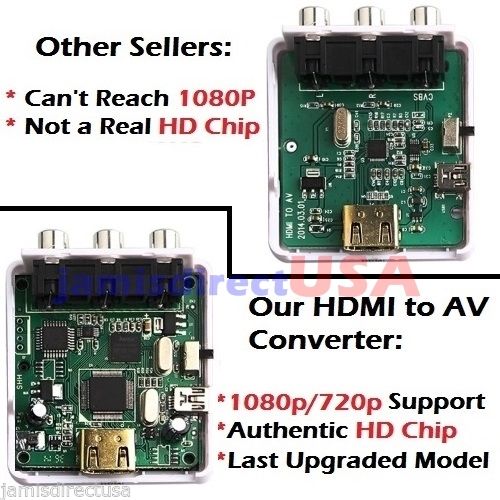

It is however th picture is different than the actual. they say the new version is different. here is a pic of the new one. You will notice it is very similar to the 'white box' and even says HDMI2AV on it...
You'll also notice it has the NSTC//PAL switch, the mini usb. and also has the spots on the board where the audio L and R would have been.

For the cheaper ebay/amazon Chinese "white box" ones we should get the ones with the bigger chipset for slightly better resolution on the input side. But they still only do 480i on the AV output side.
Ebay link: http://www.ebay.com/itm/HDMI-1080p-...omposite-Adapter-Converter-HDTV-/151565644956
And yes we may need to power them through the USB port if the camera doesn't have 5v on the hdmi.
I had to power the aerial pixels one to get it to work. I have the amazon one I posted but have nto tested it yet. I would be willing to bet it is fine as it is the one with the bigger chips. Yeah not all the 'white boxes' are equal. My guess is the big chip ones will work when powered and are alot cheaper, and I had to power the aerialpixels one anyway. I contacted aerialpixels and the only reply I got was that I didn't need to power it and they test them all with GH4s before shipping, they said I could send it bact to them to be retested but I didnt bother since I got it working. Is it possible that some hdmi cables carry power and others do not???
