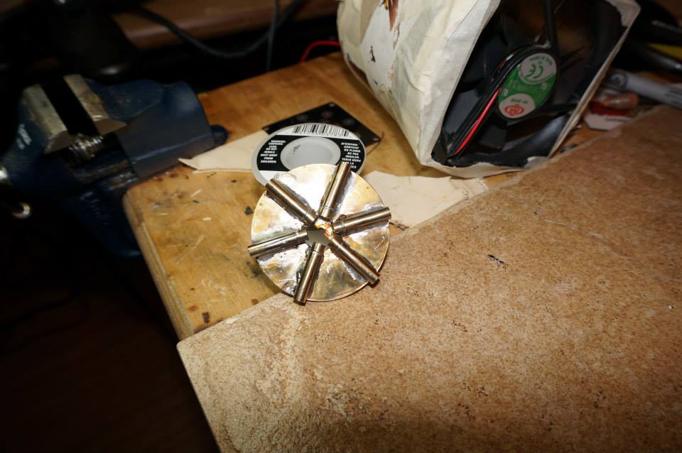

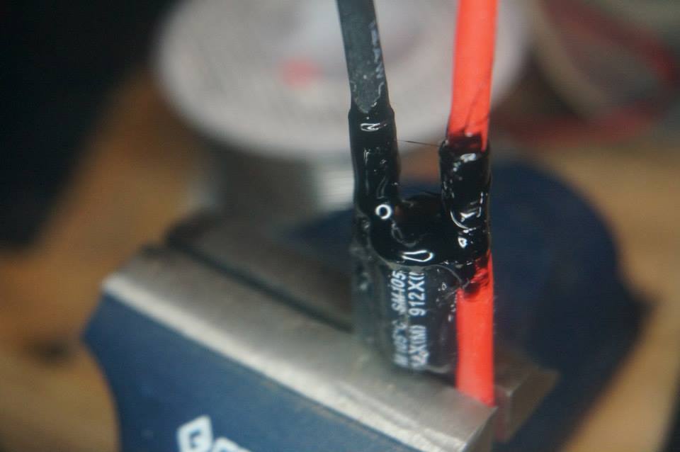

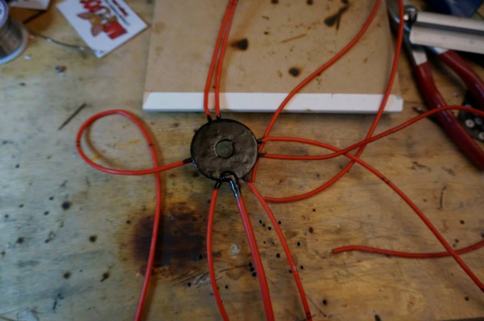

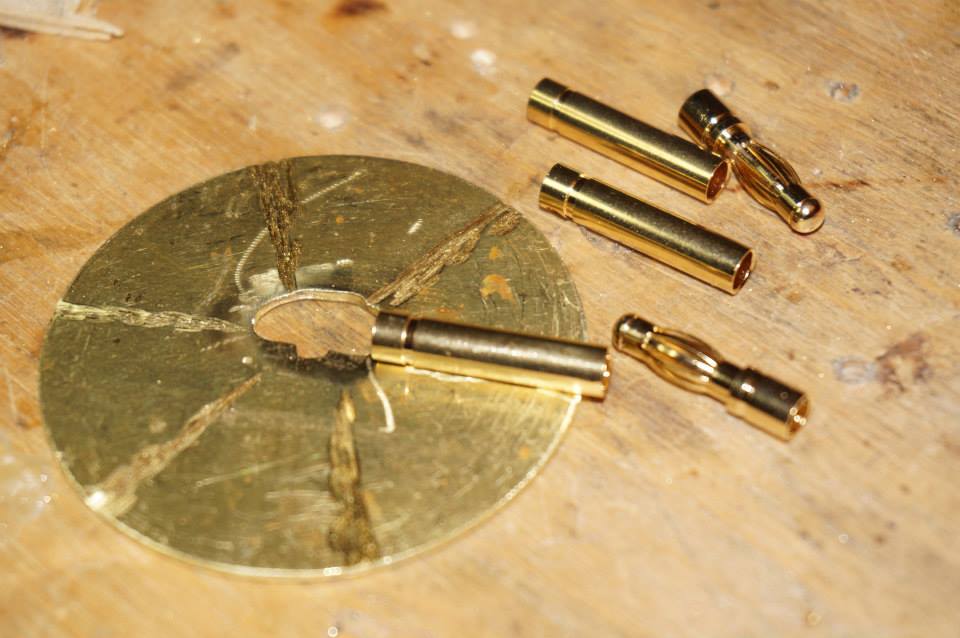

Hey all,

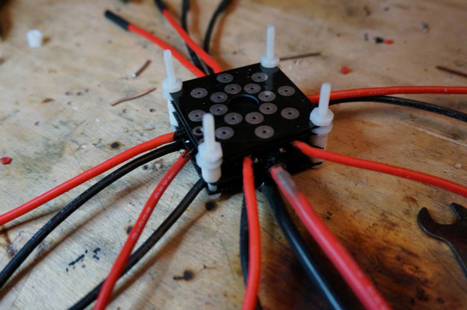

I'm trying to set up my low voltage on my Tarot 960. DJI Naza V2.
I'm running two 5300mAh batteries in parallel on a pretty much stock system except for my homemade power distribution board and 50V 220uf capacitors before each ESC.
After 7~8 minutes I seem to loose 2 volts but my mAh expenditure is only 2.7%.
I started with approximately 25.2V in each 5300mAh battery running in parallel, after 7~8 min I was down to 23.2V but when I balance charged the batteries in parallel I only needed to put 3868mAh to bring them back to full charge.
This is really strange to me and I don't know what's going on. Is this a battery problem or is this some kind of inefficiency in my system? But I think it's something to do with the way I'm setting things up. Anyways this my Power Distributer that I made of brass, I know this not as conductive as coper but I can't see this being my issue. Here are some photos:
View attachment 14918View attachment 14919View attachment 14920View attachment 14921View attachment 14922View attachment 14923View attachment 14924
I hope this makes sense. If not please feel free to ask questions. I really want to get to the bottom of this.
