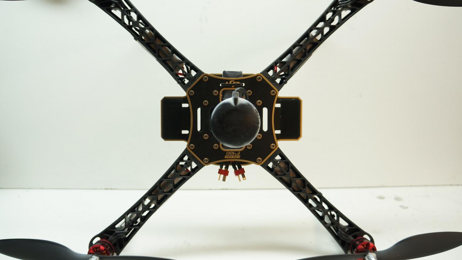

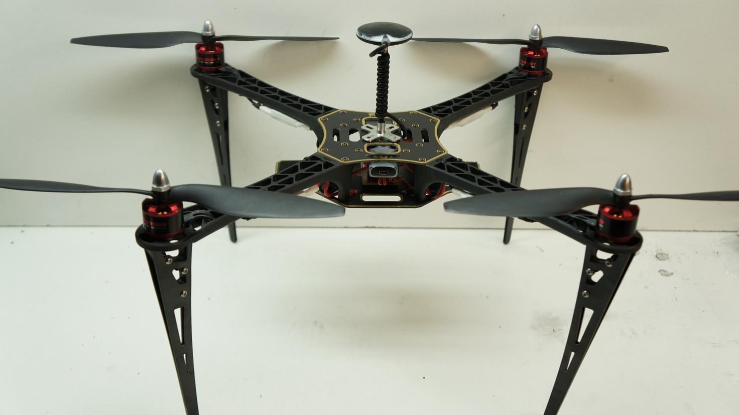

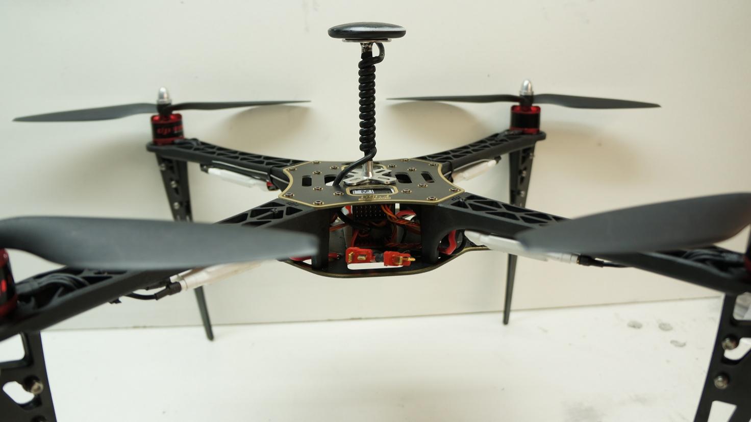

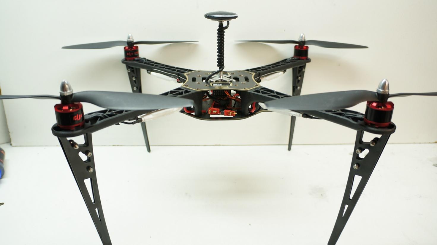

Well Here we are 7 years later and with the new Auto Pilot systems out there I decided to try it again...
So I went out and bought a DJI F450 and NAZA system with a Futaba T8JH and S-Bus Receiver
I built it in less than an hour and had a friend setup my T8J and all of of sudden, I can fly..........:02.47-tranquillity:
I have had more fun in the last few days that I had to share my enthusiasm with all of you
I have even crashed it a few times and this thing just keeps on going............
I broke a "Arm" and used some fiberglass and resin to put her back together and she still flew straight as an arrow........:nevreness:
I now have purchased some better Blades, All Black Arms & some landing gear (STEALTHY)
I run 2 "Hyperion" 3S 1600mAh LiPo's in parallel giving me 18 min. Run Time
Any suggestions to improve flight are most welcome

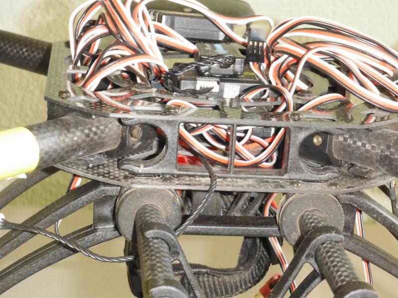

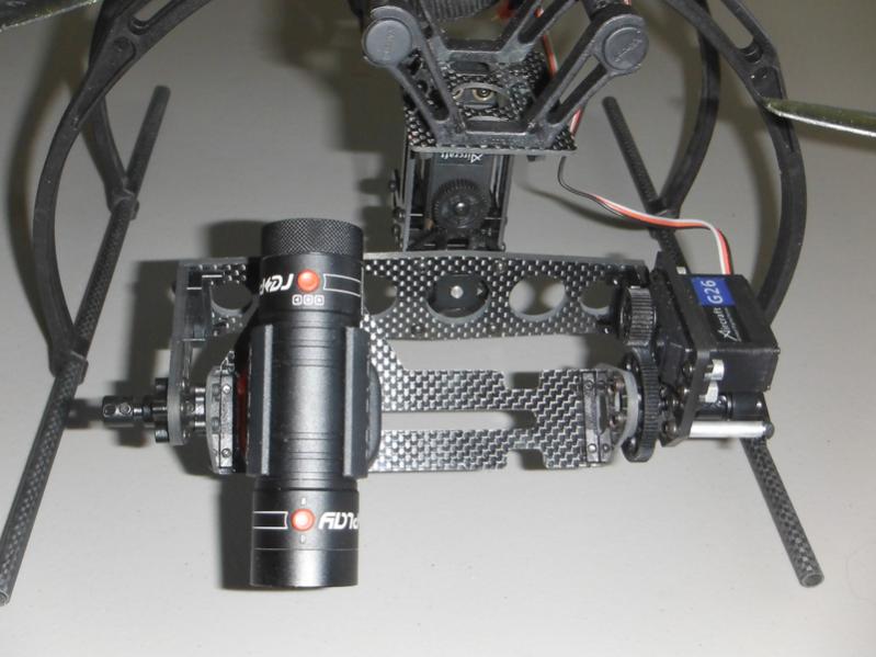

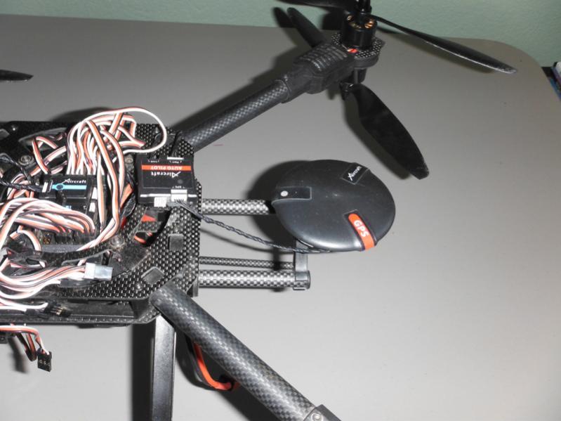

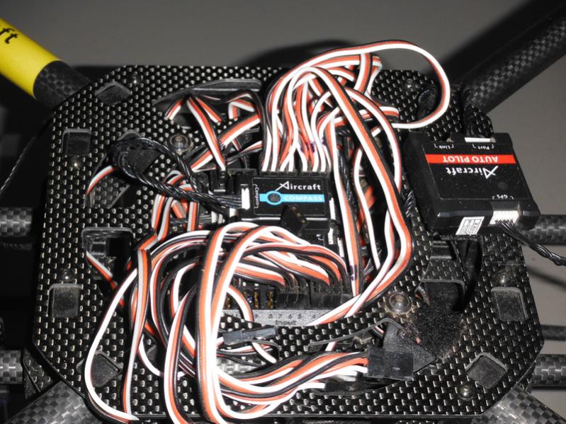

View attachment 7091 View attachment 7092 View attachment 7093 View attachment 7094 View attachment 7095
Future Plans are to purchase the DJI S800, WooKong-M and the Z15 (Since I already have a Sony NEX 5N)
hope you like it
Best Regards Rick

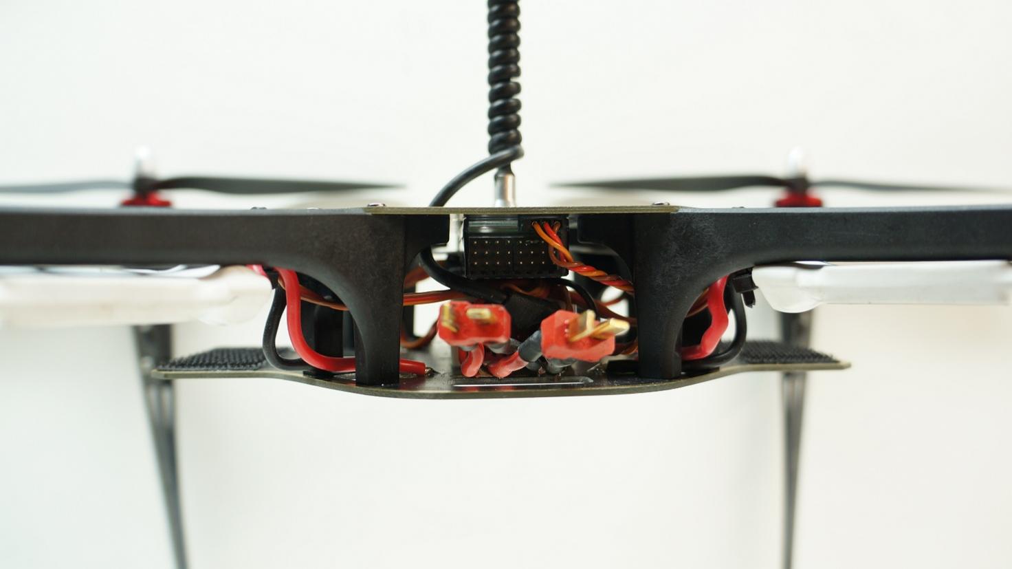

see how theres wire touching the top of naza, try keeping that all clear. The rx is fine, just don't let anything touch the little white box. She'll freak out and lock over the gyro on ya
