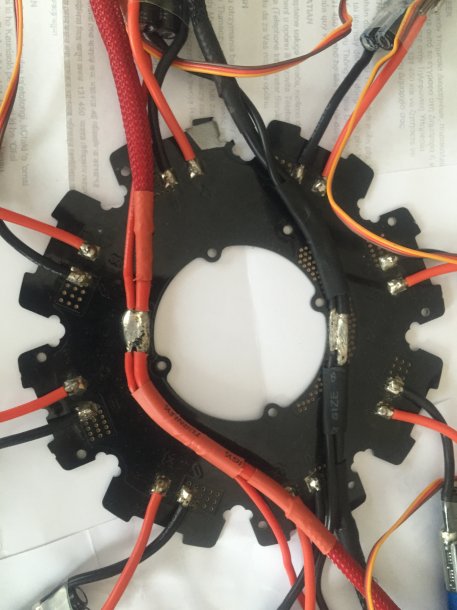

Would best practice for Power distribution boards be to replace with a new one if I was to swap over my ESC's. Or could one use the current solder joints to replace.

Rentakill
Quick question if anyone can help, replacing ESC's with same hobbyking 40a blueSeries or Hobbyking Blueseries 40A speed controller flashed with Simonk firmware. Price difference $7 each.
Will I see any benefits using simonk ?????
