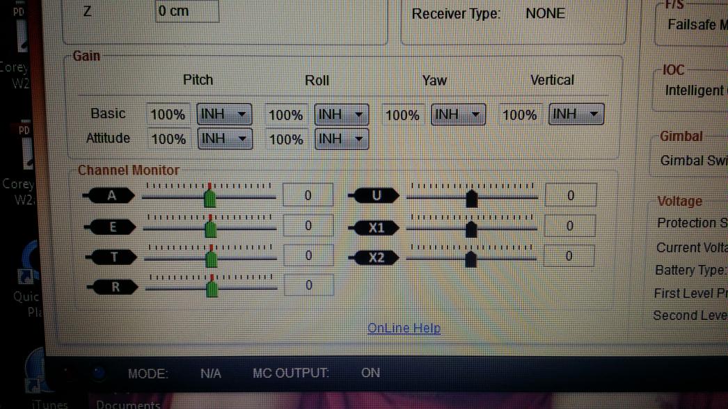

cbuk
Hi Steve,
Could I jump in with a question? You mention gyro and altitude in your gains setup but these are different to the variable listed in the Assistant software; what do you mean by these? I'm guessing altitude = Basic Vertical, gyro = Basic pitch and roll and Attitude = Attitude pitch and roll.
If I'm right this would mean your setting are 170,170,150,150 for Basic and 70,70 for Attitude. Is this right?
Chris
baja-king
Here for the ride :)
Share your Gain settings...
Hi Chris, you are correct... please see attached picture
garyl
As always you're very welcome :)
Hi Steve,
For my first flight I started a little lower than those you quoted but now would like to try your gains. So as on the A2 assistant the set up is a little different can you tell me if this is how you would enter your gains. ( I started with those given for the S800 which is all around 140). The first flight went well ! Thank you. Gary
