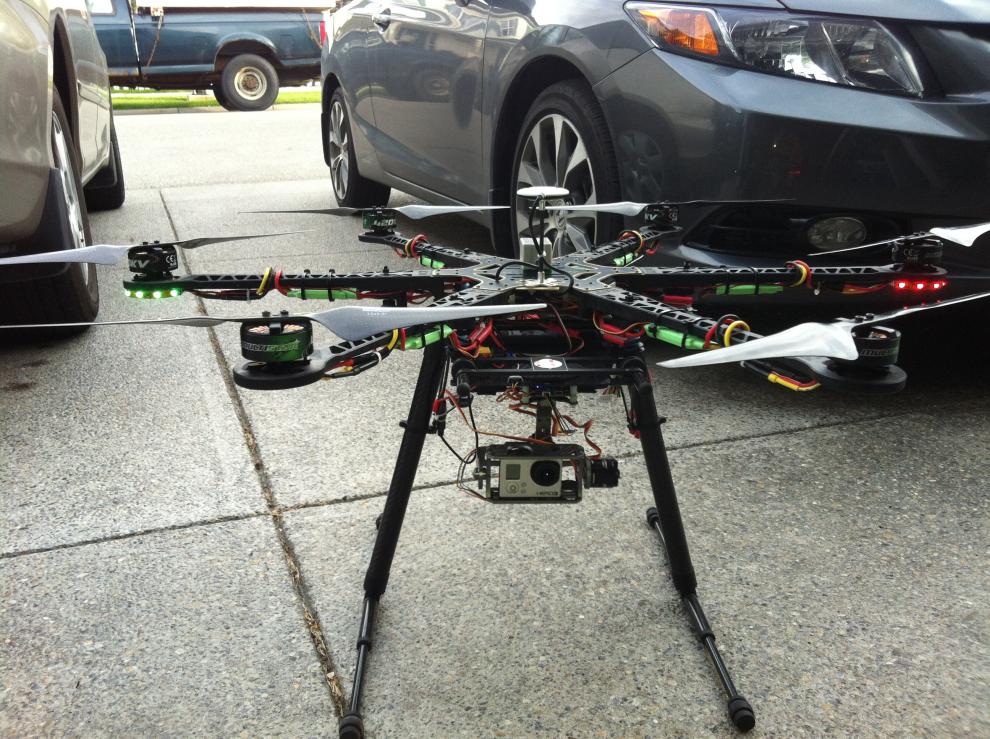

Excellent..... give me a sense of hope........which WKM firmware are you using and where is your IMU positioned? BTW - Here is my custom 800mm Hex c/w GoPro on brushless gimble in gusty conditions....... buckaroo bonzai.... My IMU is mounted top dead center but maybe the props are exacerbating the barometer sensor issues. This system flies flawlessly in still air and light steady breezes...... https://www.youtube.com/watch?v=Dti_bPGPaRg

The attached image shows how the wrong placement of the IMU can lead to strange flight behavious caused by baro sensor issues. In this case the nearby props exacerbated the gusty wind effect causing altitude sensing challenges for the controller. The IMU needs to be located away from prop wash..... hence the addition of the DJI anti-vibration kit that allows you to relocate the IMU below flight deck and away from severe air turbulence. The anit-vibe components also help.View attachment 12501
