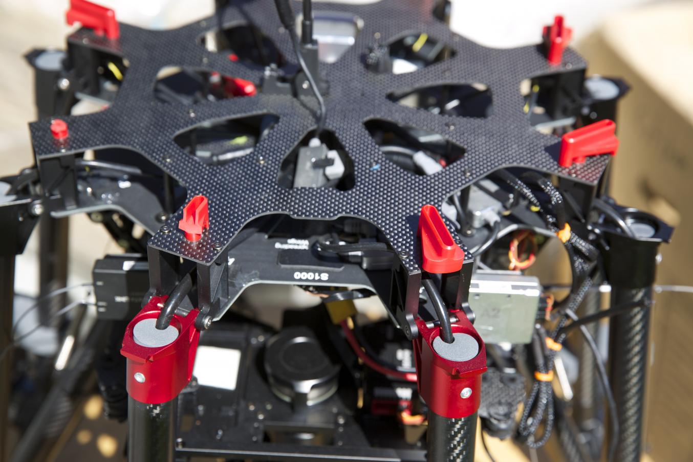

My build is coming along nicely - many thanks to the likes of Chris and Ed for their input - I do have a question on placement of the WKM components - am I able to plug the IMU into any Can-bus port or am I restricted to the MC?
Would make life much easier if I was free to place alternatively come breaking down the S800 for transport.
deluge2

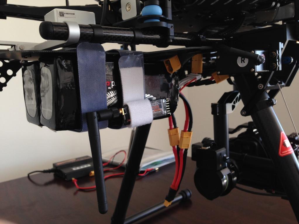

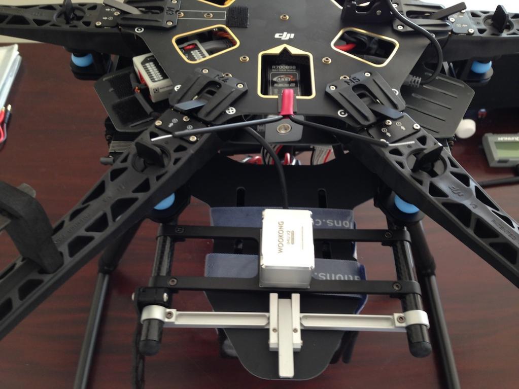

Thanks for the build pics and the "boring" video. In this context, the last thing you want is an 'exciting' maiden flight. Flight time vs. energy consumption sounds promising. What was the total capacity of your two flight batteries? Looks like a very clean install, the braided cable covers look great. Perhaps it's the angle of view, but your primary receiver antennas look like they're not at 90degrees (Z15 receiver antennas clearly are at 90degrees). Can you post a shot of the whole top deck? Did you balance props and or motors?
Looking forward to more video once proving is completed. Congrats!
Steve
thought I would up some pictures, I think its a great idea to wrap or braid wires on the S800 to protect them from damage - also makes it easy to spot when something is wrong - well in my mind anyway. Again thanks to the people here for assistance during the build and beyond!

Hi Steve I will put up some more pics tomorrow - the main antenna is definitely at 90 degrees but they also angle upwards so it makes it look a little deceiving.
My batteries are all Carbonbird 6S 5050mah from http://www.multiwiicopter.com/ - for some reason doesnt have the 6S on his website but I have been using the 4S for ages and I can only put them on par with the Overlander Extreme series. Didnt balance props or motors but did another flight today now that I have the retractable legs hooked up and took some more video to see if the props were tracking well.

Hey Lance, very nice build! You put me to shame with your perfection!
It's a rainy day in France, I've finished my testing after the rebuild. She is behaving perfectly (after I replaced the faulty ESC).
Time to install and configure the Zenmuse/SonyNex7 - I'll have some test video up soon...

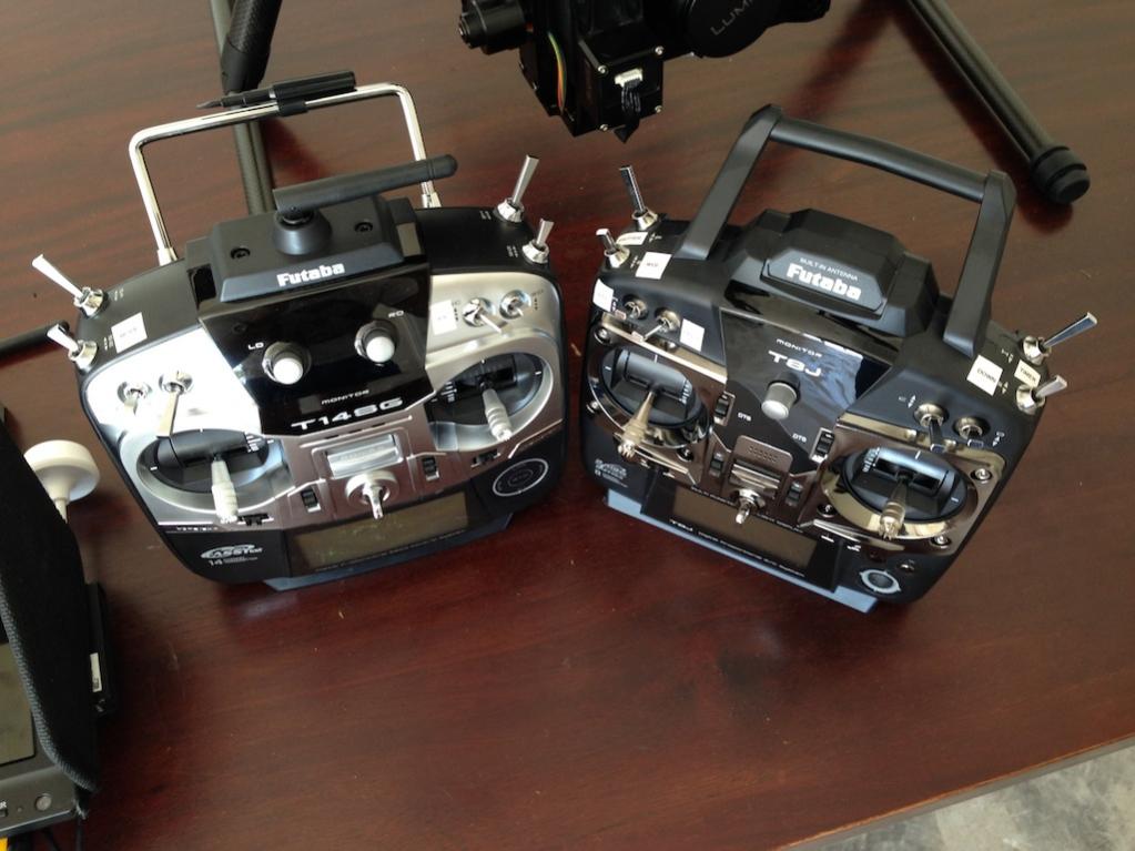

While you're online, can I ask about your TX setup..
Have you set it up as a 1 pilot operation? This is what I have to do (I don't have a nice camera-woman like Boranup!)
So my primary TX does the flying and the secondary one does the rest.
But with the secondary one I only get 6 channels, and with one used for the retracts that gives me five..
The GCM has seven, so what ones can I leave out? I think I want to be able to trigger the shutter and turn video on and off, so I wonder do I need Roll and Pan connected?
