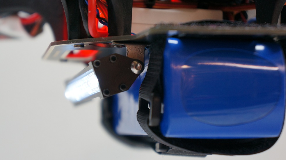

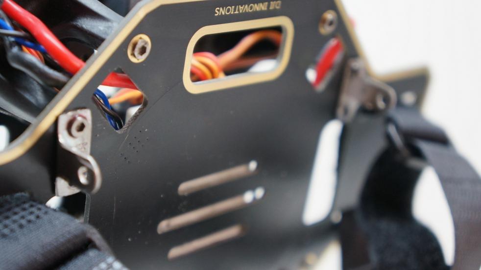

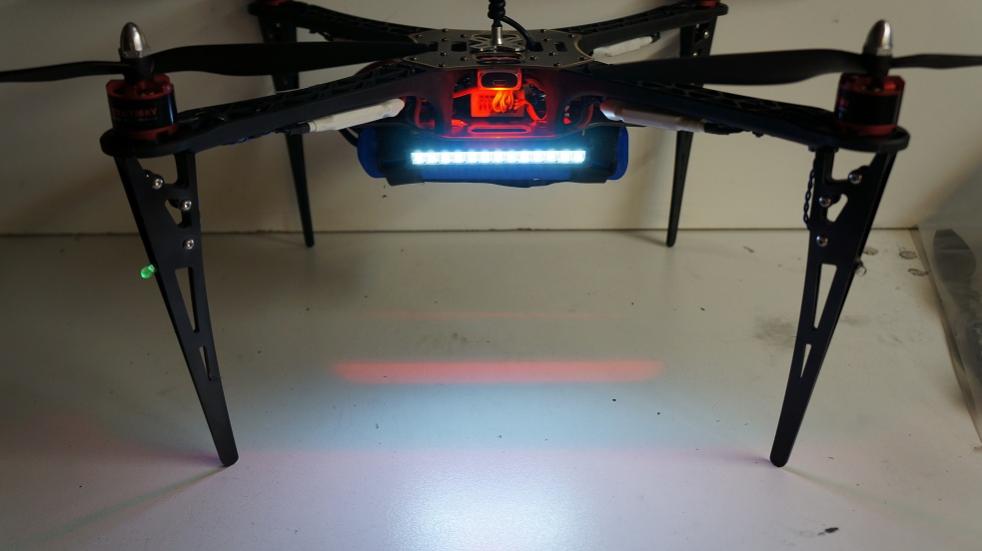

Heres my Installation on my F450 (some bench grinding required)

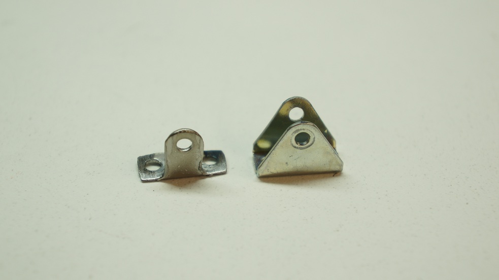

First I used a Bench grinder to grind off one side of the bracket and shape them
for extra pivoting of the light bar (Bracket Sold separately)
Then I removed two of the "F450 Lower Arm" screws (One from each side) and attached the brackets
Then I simply screwed the "Gear Head" Light Bar to the brackets and ran the
wire through the chassis & plugged it into my receiver .........
I flew her last night in a near by parking lot and shot her up to the stars through the fog.
In a matter of minutes, I could hear people in the distance saying "Look....Its a UFO"...........lol
I was really suprized how far I could see the Light Bar....It really is Super Bright !!
