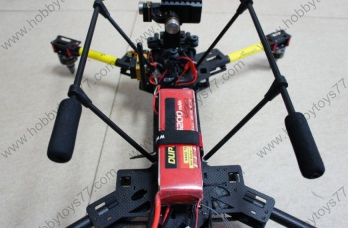

Gbillerty
Dont know the exact weight of the machine but the retracts handle the weight of two 8000maH batteries. There is still wobble in the servoless retracts. I think I could work it out...
