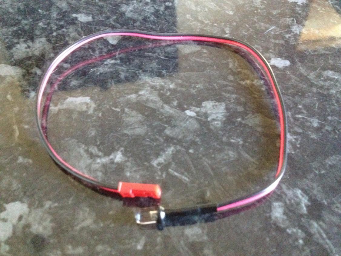

There was a red LED that came with Lanc Control V1.0 It flashed in different sequences to let you know if you were recording/shooting stills. This way you can be sure. I checked their website, and V1.0 is no longer available, but when I got my V1.1, I emailed them enquiring about the red LED, and he said if I wanted it, he could post it out to me, but I'd have to solder it on to the V1.1 board myself.... It's in their original video here :
This is what you need :
attachment.php

If you go to Maplin's or CPC or your local electronics store, you can buy a small LED, and just solder it to pads LE+ and LE- on your V1.1 board. This will work the same, and the flash sequence will still be the same as in V1.0.
