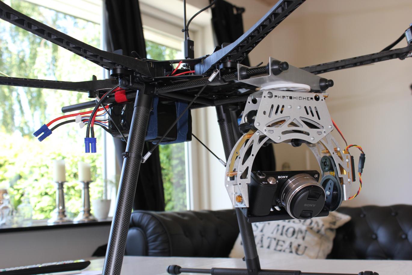

DJ's shutter release mod is an option as well. he's got the directions posted at the photoshipone.com website
it allows you to wire the shutter to a switch that you can control with a servo channel. once done, it works great.
