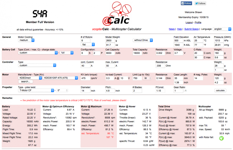

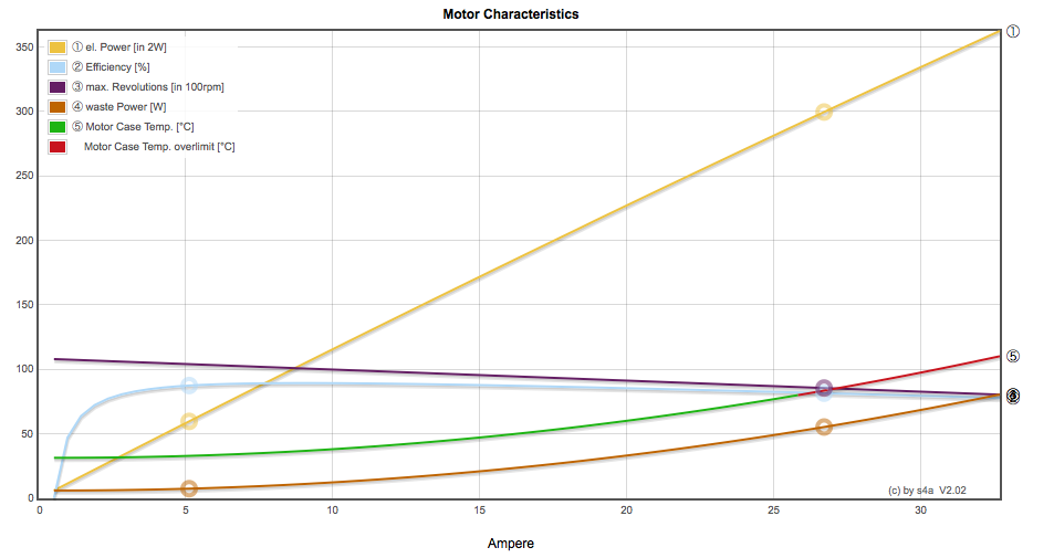

Here you go. I just left my numbers in there for most of it except motors. If you go InfinityMR route that is more weight and you are including an FPV setup which I don't have that adds some more weight too.
I wouldn't worry much about the max. temp warning too much as you won't be flying with it wide open but if you are in a hot place and with proposed additional weight this may be an issue.
I'll defer my overall judgement to others who are more experienced and knowledgable.
Thank you for checking!! Would a lower kv motor or something else best account for that?
Mactadpole
If I change the motor cooling to good then all is fine. I just noticed hover throttle is at 36% so that gives you room for additional weight with loss of flight time of course.
crayfellow
seems like using all those same numbers and going from 3510-475kv to 3520-400kv opens things up, The motors only cost a little more, but we'd also (according to KDE) need the crazy 55A ESC's so altogether the cost goes up a LOT.
Otherwise... smaller prop? I'll try to figure out AUW vs. yours but I'm sure it's just as you said, pretty much the same as yours with a bit more for GH4 vs. Sony, maybe gimbal, etc.

I'm thinking about your AUW and its going to be significantly more than mine. I bet your camera setup alone (GH4 w/lens) is going to add a minimum of 400 g over what I am. I think the InfinityMR is also about 500 g heavier (or more) than the Quadframe V2 gimbal.
I think you need to think about going up in prop size.

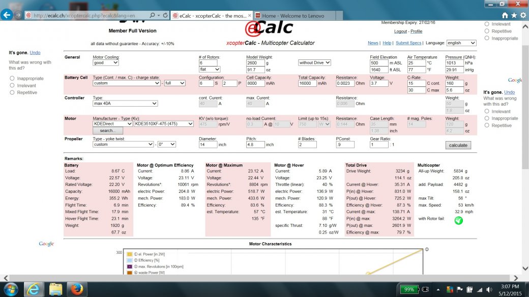

Your over propped in this config. need bigger motor.
Correction: I ran your figures and this is closer to where your at.

how do we reconcile "Good" cooling, since in ecalc this is the difference between having a workable config and not?
