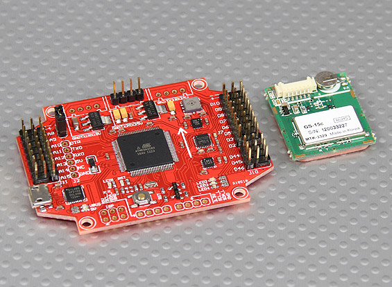

Which Multiwii Mega Pro is it? If it is the Blacked version then there is not a MAG on the FC. It's on the GPS unit. And if it is on the GPS unit, you have to be careful that the GPS is pointed in the correct direction (as I found out). There is not a North indicator on the module so it's easy to mount it incorrectly. That will cause you serious problems during GPS Position hold or RTH. You have to be in the GUI to determine the correct mounting direction of the GPS module. You have to face your Multi North, and then rotate the GPS module until it also faces North. Of course if you don't have the Blacked version you can disregard.
Raldan
Facing north, I missed that part. I got the MultiWii PRO Flight Controller w/MTK GPS Module from HK. I need to understand what modes I need on to hover with GPS lock. More reading to do. Thanks, guys, I'm learning more everyday.
