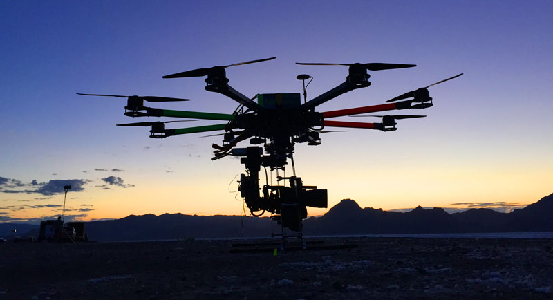

I'm one of the ones with the 1250L/U7-490's and VERY happy. Got it dialed very nicely with an M5/GH4 and 17" props, then turned around and stuck a Red Dragon on there without changing anything, and went straight to Bonneville on a Nike shoot. Had rotten luck with the Aeronavics quick release, dropped that for Andrew's custom isolation mount (properly designed I might add by people who know how) and haven't looked back.

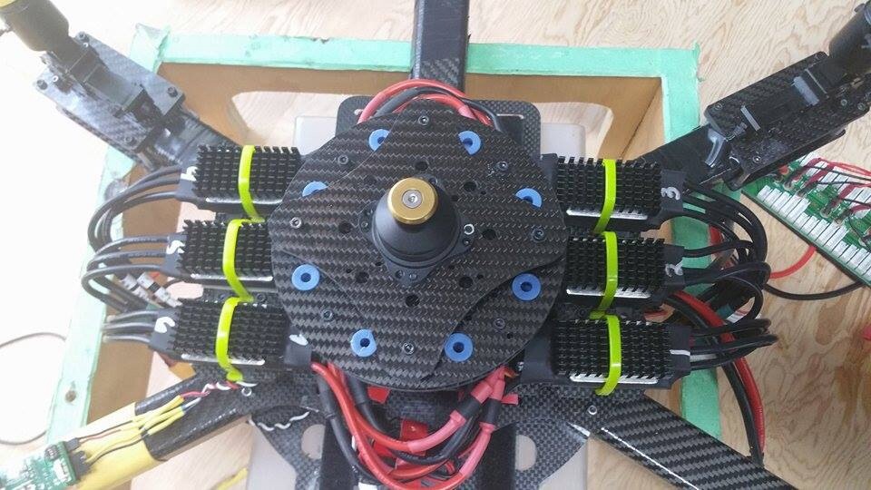

I can tell you that my flat hex (1100mm) with u7/490 I can easily take the weight of a stripped down red and lens with 17" props and gh4 with 16" props. No crazy hot motors or esc's at full load and very cool with gh4 and movi m5.
I think if you go with tmotor my heatsink mod is worth doing. If you need a payload bigger than 7-8kg than I'd go with the flat 8. View attachment 25781
