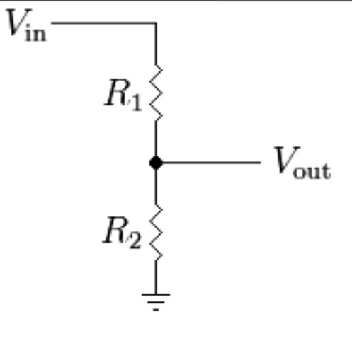

I wonder if a voltage divider could be used such as this....
If you used two 10k resisters, you'd essentially divide the voltage in half.
The formula is V-out = (R2/(R1+R2)) x V-in.
So if you used 10k ohm as R2 and 3k ohm for R1, with a 6s battery it would be:
(10,000/(10,000+3,000)) x 22.2 = 17.07 volts from your full 6s battery. The regulators on the HFP would take care of the fluctuations as the battery depleted.

That's not a bad idea, but I think 10k would be problematic as I would plan for a maximum of 400mA. You would need a resistance no higher than 44 ohms to allow for this flow of current. Keep in mind that I make my living in computer science not electrical engineering, but I'm pretty sure your voltage would drop due to the current required by the HoverflyPro with 10k. I'd play with several values to see what voltage you get. Ideally, you want no lower than 9v with your flight battery completely depleted.
I would avoid tapping specific cells as this would un-balance your battery! Meaning you could potentially over discharge several cells during flight.
