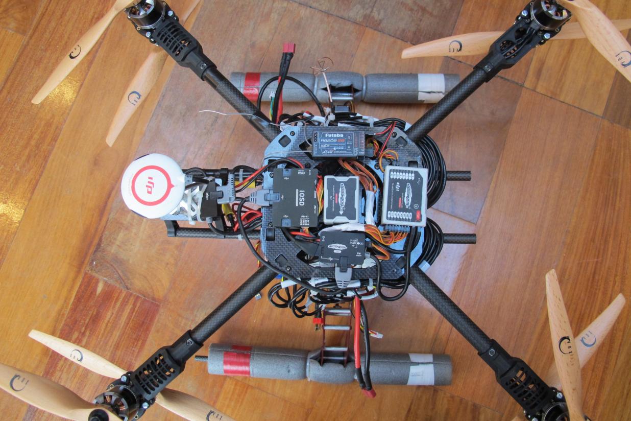

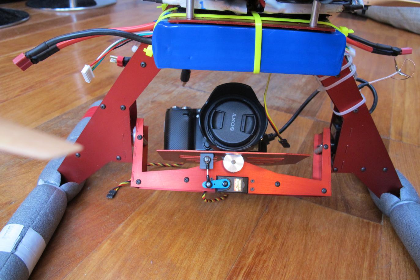

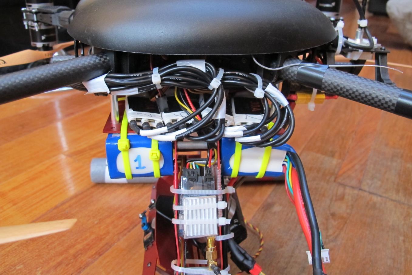

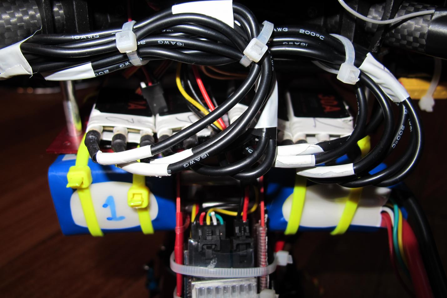

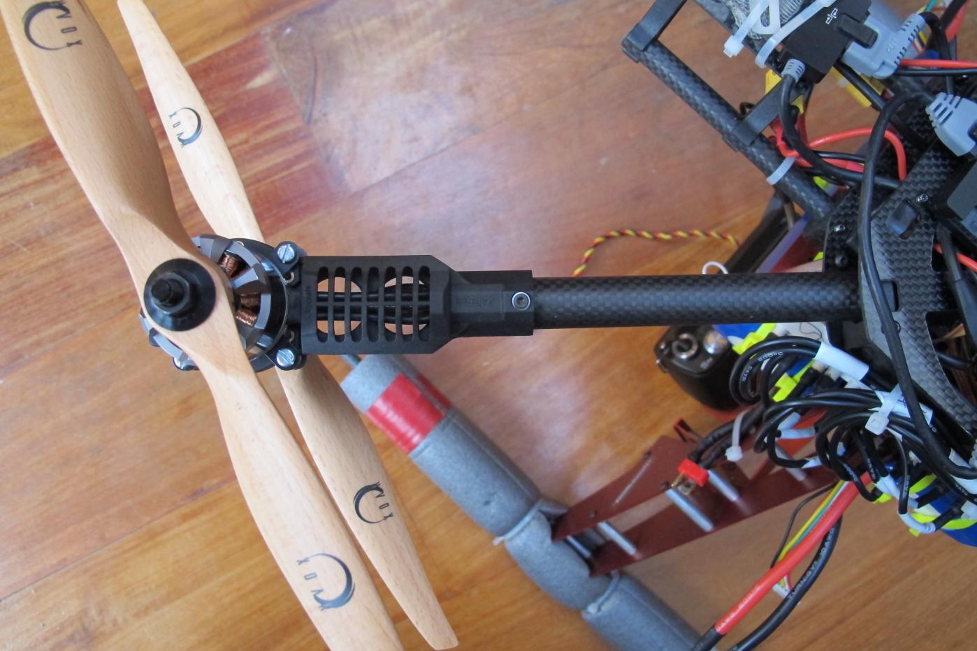

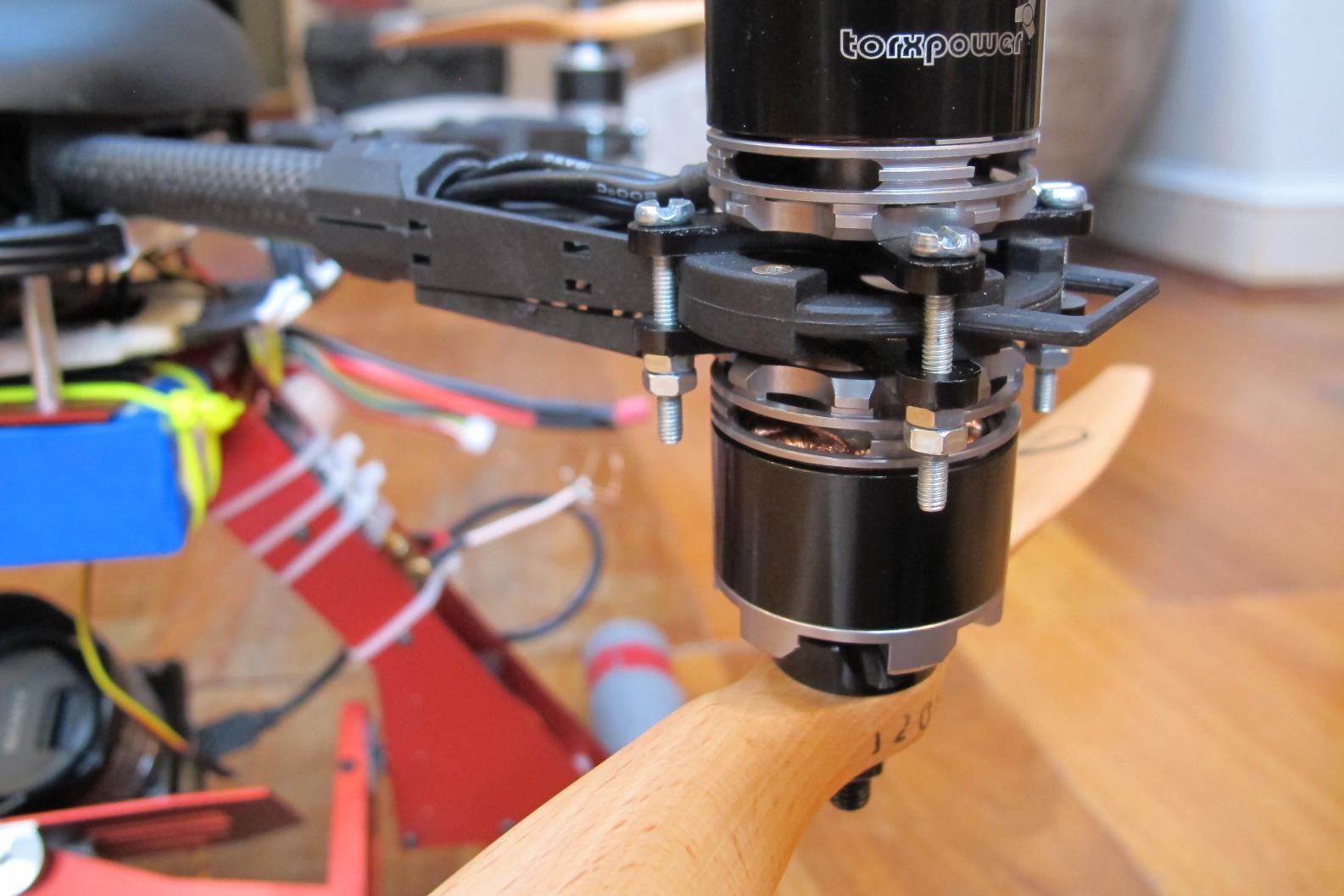

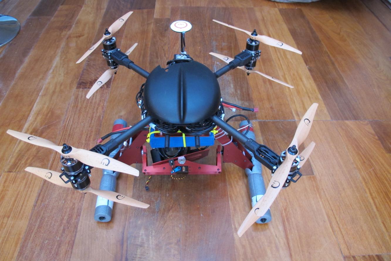

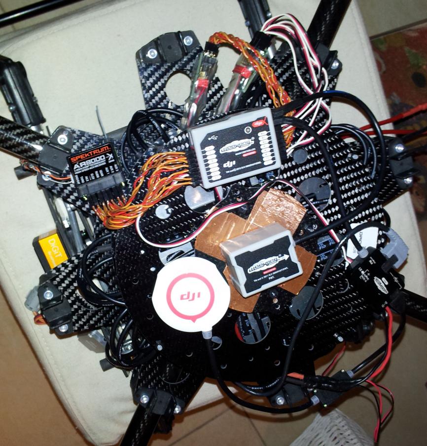

Hi all thought i'd post some pics of my build incase anyone is wanting more power from their x650v8.
I'm upgrading to a skyjib x4 but untill i have enough money for the frame i decided to pimp my x650 v8 with the parts i've bought.

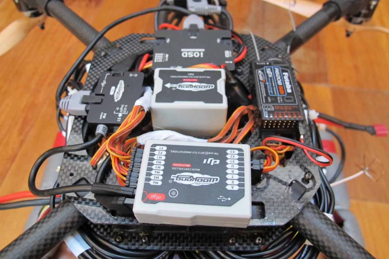

Upgrade the FC to Wookong M with OSD.
Upgraded ESCs to DJI 30a.

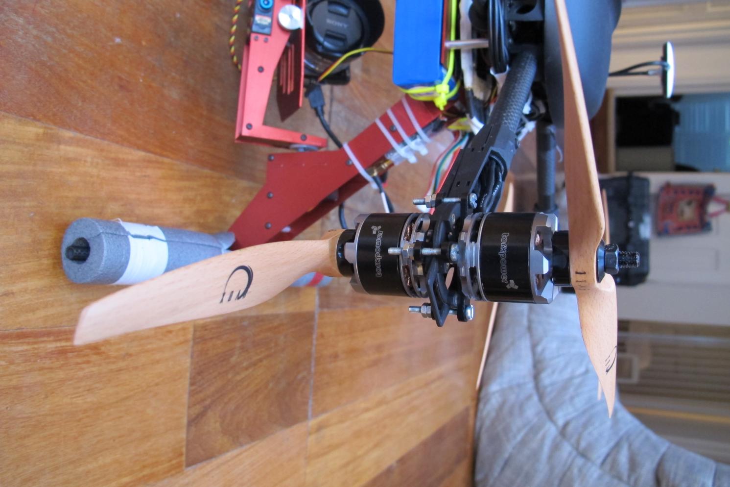

Upgraded motors to Torxpower heavy lift 3536.
Upgraded props to Xoar 11/5.
Lipos 2x 5000mah 4s Turnigy in parallel.
HF-X Red 2 axis gimbal.
I'm using the xaircraft fc as a stand alone Gimbal controller as the WKM is pants!
flight time 12 minutes leaving 3.75v per cell
My AUW with gimbal Sony NEX5, HDMI-SD convertor and Video TX is around 4300g.
Speed is around 25mph / 40kph according to the WK OSD.
Must thank Dixter for his thread on motor upgrades it was the way he mounted his motors to the x650 motor mounts that really helped.
feels totally different to fly now so much more power, took it for a spin today 20mph gust of wind but WKM holds it really well. i'm pretty new to MR so i'm finding this good training ship before i get the skyjib.
Gimbal is still twitchy i'm controlling tilt from another radio but i need an upgrade. would like to buy the AV200 360 with a dedicated stabilizer maybe picloc as that is what i'll use eventually on the sky jib. think i've got enough thrust to take it now.
Cheers
Olli

that looks fun, nicely done. so how is the onboard footage? does the "twitchy" make it pretty unusable?
When the camera is set level its ok. but then there isn't enough rotation in servos to tilt the camera 90 degrees down, So i've angled the camera at around 30 degrees on the servo. So i can move between level and straight down from my 2nd radio but since doing this the tilt servo twitches alot making it unusable yeah, I can't stabilize the micro twitches out. here's some stuff i shot with this gimbal before upgrading motors. https://vimeo.com/the11littlefilms/review/49092274/14f230815b left the crop of on the stabilition in after effect so you can see how much movement there is.

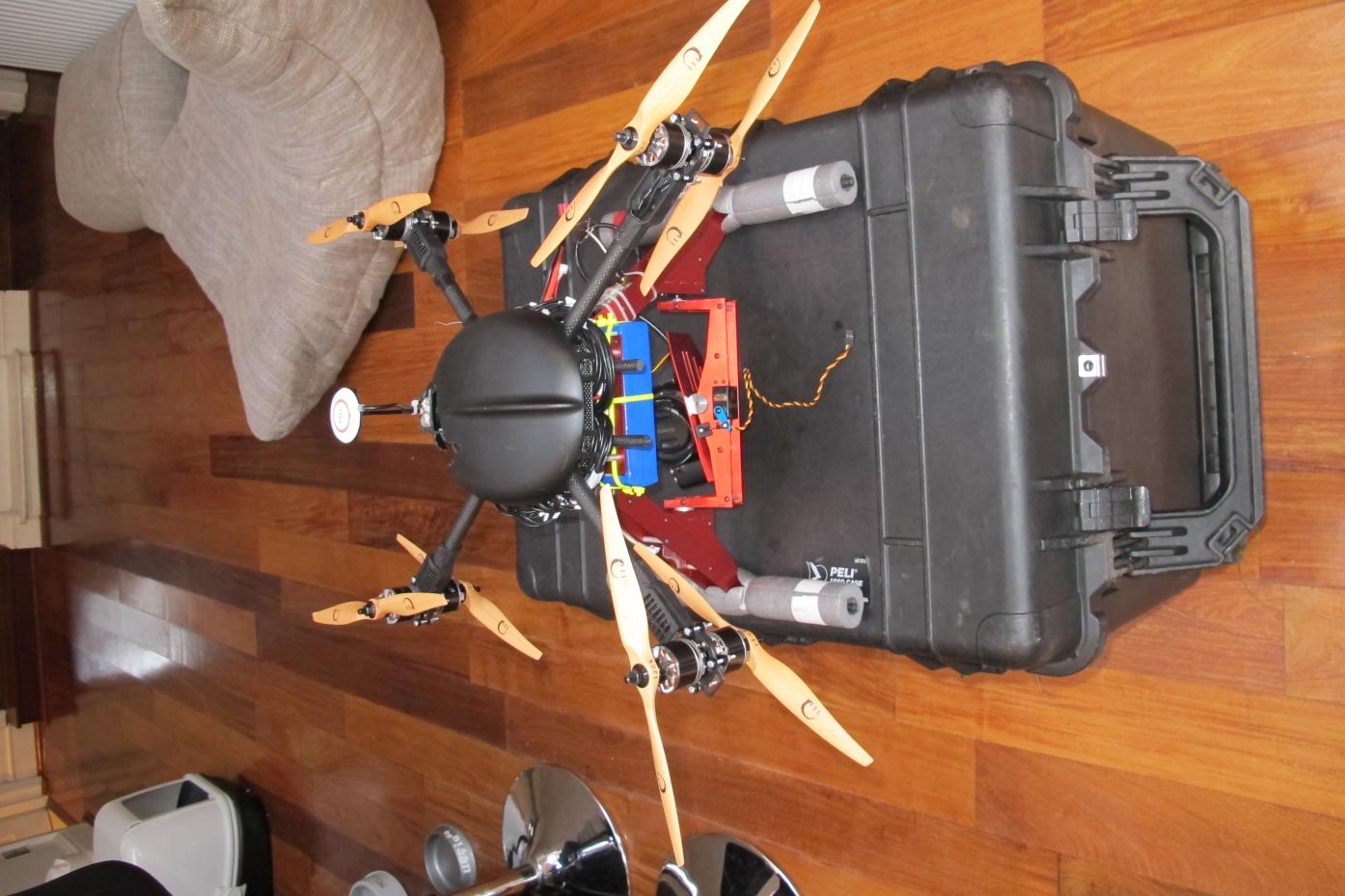

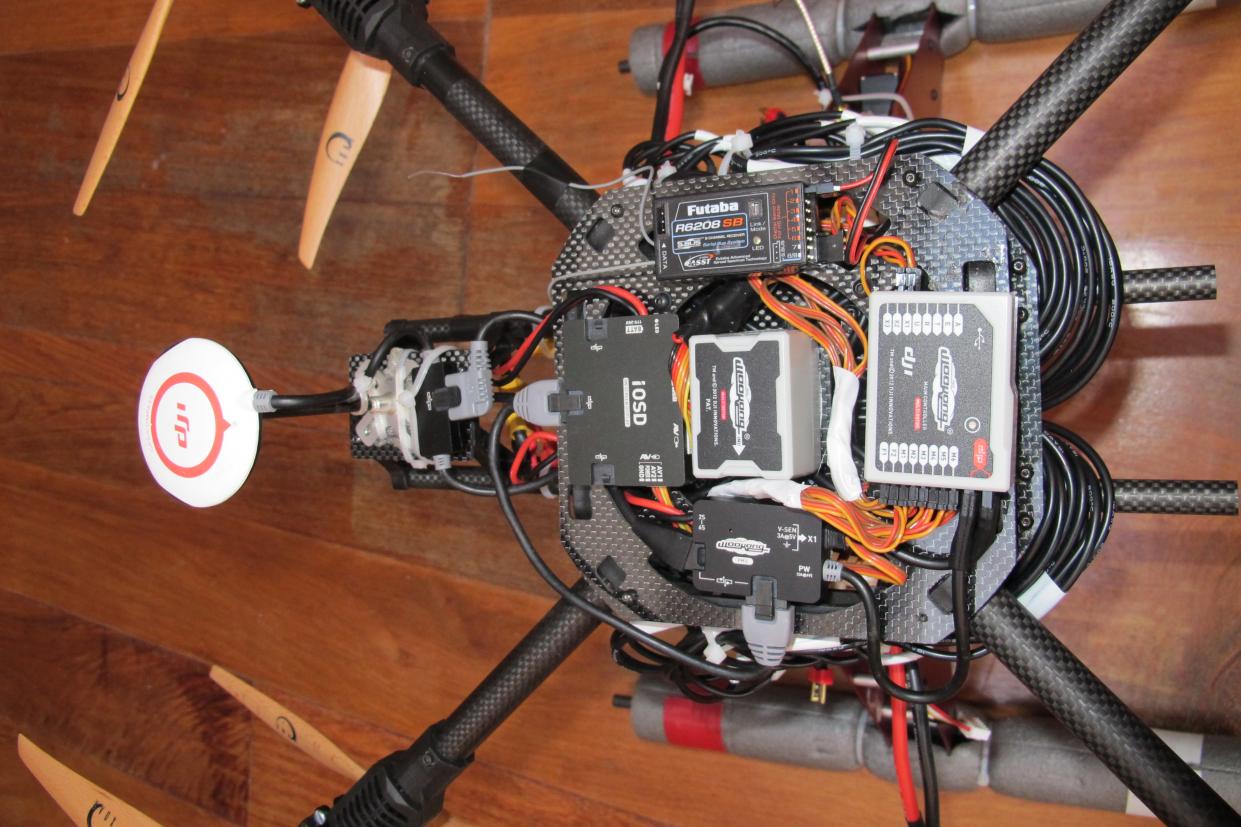

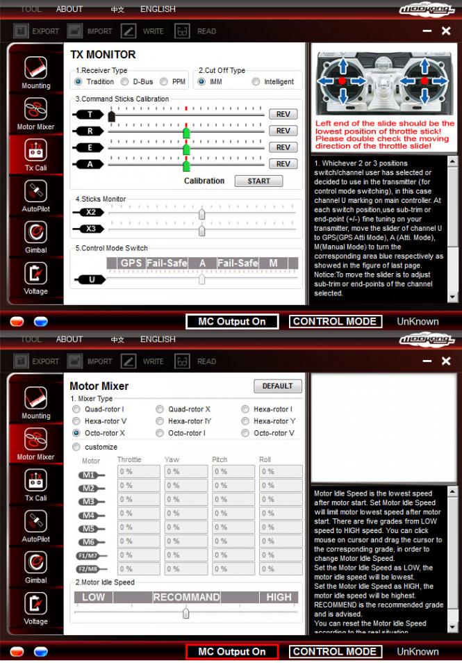

Look at your second pickture, at the IMU. The arrow on it is supposed to face the front, making your #1 boom to the front and left. Don't try to fly this way.
With the WKM it can face that way as it is adjusted on the WKMtool. Unlike the Naza

Xaircraft 650 v8 also pimped!!!

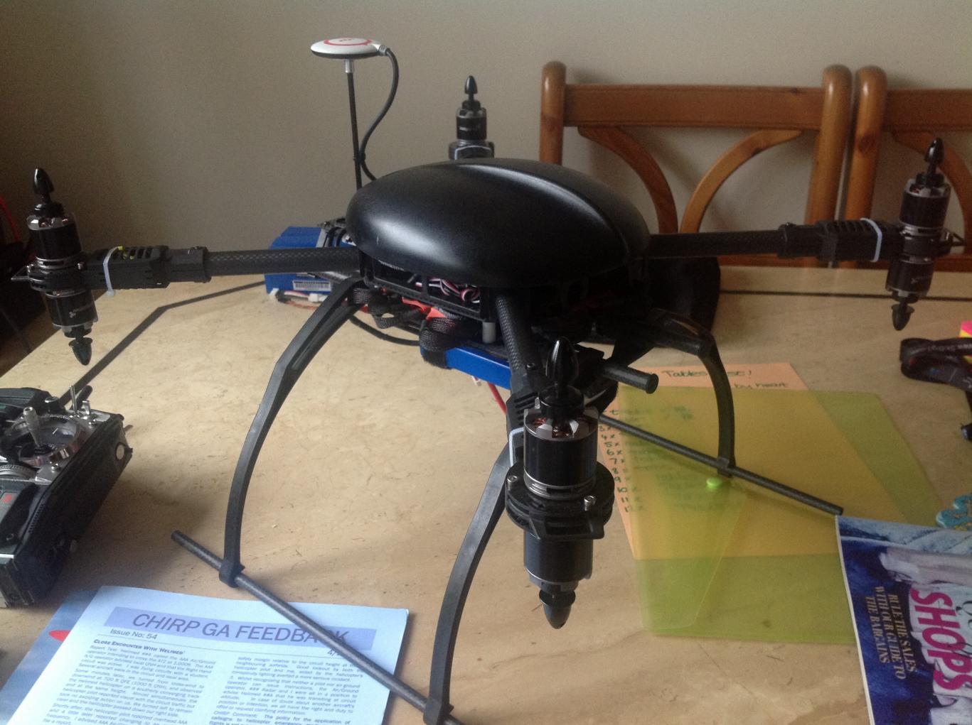

I have just modified my XAircraft 650 v8. I will post better photos when I can, but the result is the most perfect quadcopter that I have flown.

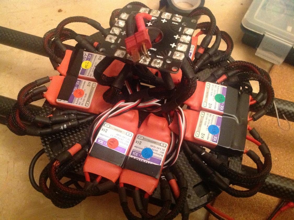

I added the following:
Wookong M
Torxpower 2216 800s
turnigny 30amp ESCs
Graupner eProp 10s
Spacers and a new 'floor' to accommodate the ESCs
New screws - all Stainless
I am using 3s 5000s but have bought 4s 5000s, which I will try.
I have used standard settings for the WKM and it is completely gorgeous to fly. It has potential to carry a heavyish workload and under GPS Atti mode it just sits there in a perfect hover.
I am so impressed. Just need to fit LEDs and camera mount....
The WKM has used all the ports in the x octocopter mode, so I will be trying to source a gimbal and stabilisation device. Still not sure what to go for...

Bloody nice build Rich! looks great.
I have similar sentiments towards my HFP X650 V8 Its my favorite of my MR's hands down
Bowley, your help on this forum was invaluable. I was so grateful! It has been a lot of hours getting the x650 ready, but it was worth every second of work.
