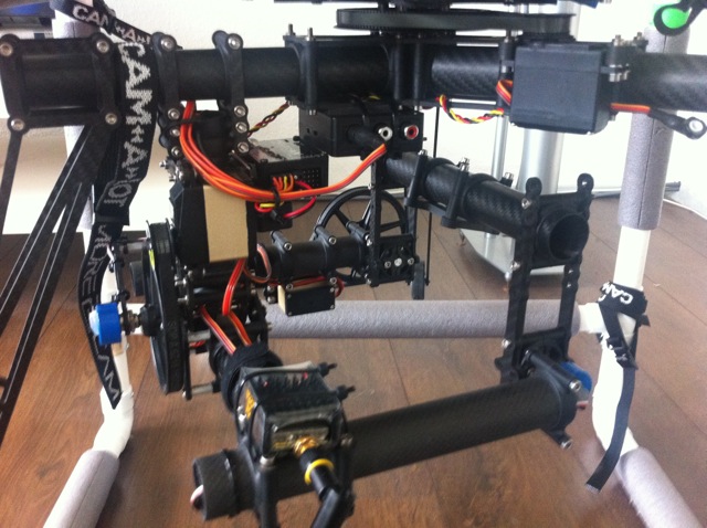

One of you successfully using picloc with a CS gimbal. I stopped testing and just started again and can't get rid of the roll drift once in the air. Would be cool if one of you could share the mounting position of picloc and settings etc.

Roll Drift still a problem tried different places and servo's. See attached images
