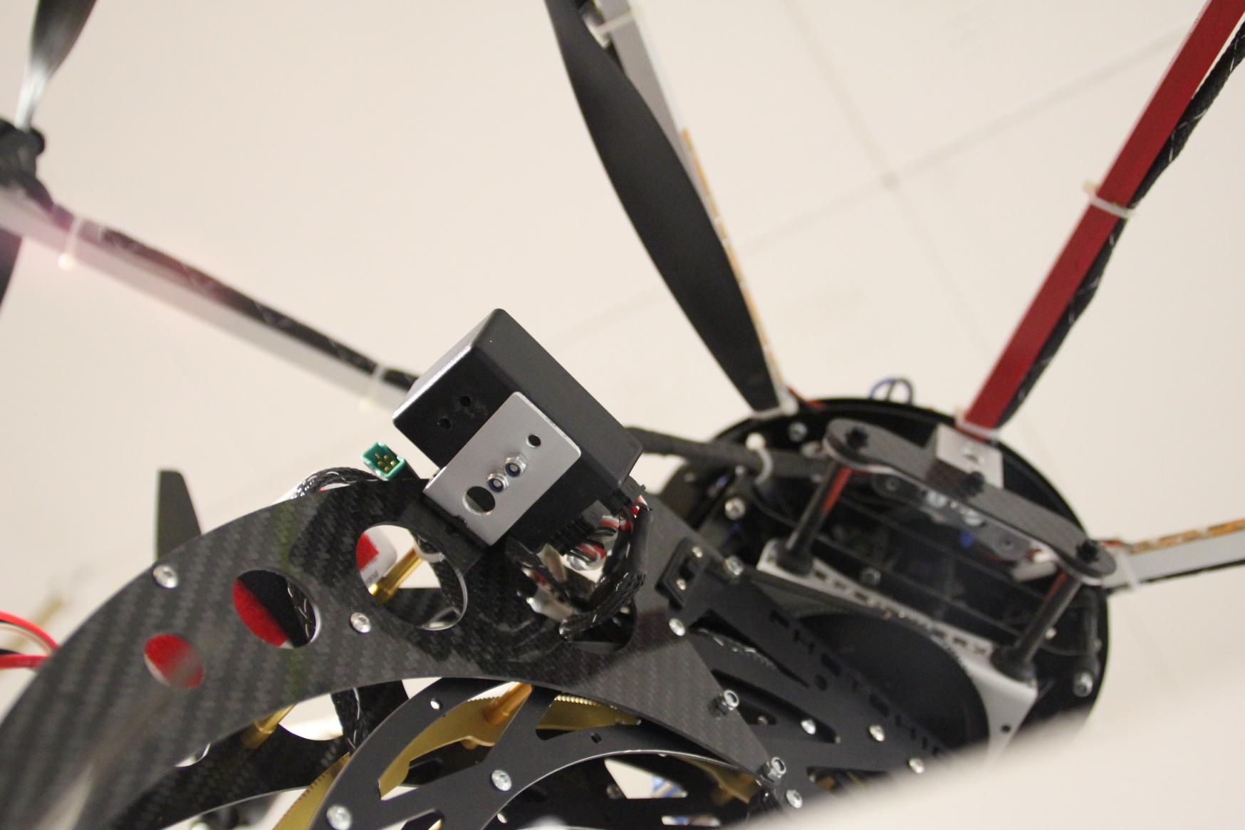

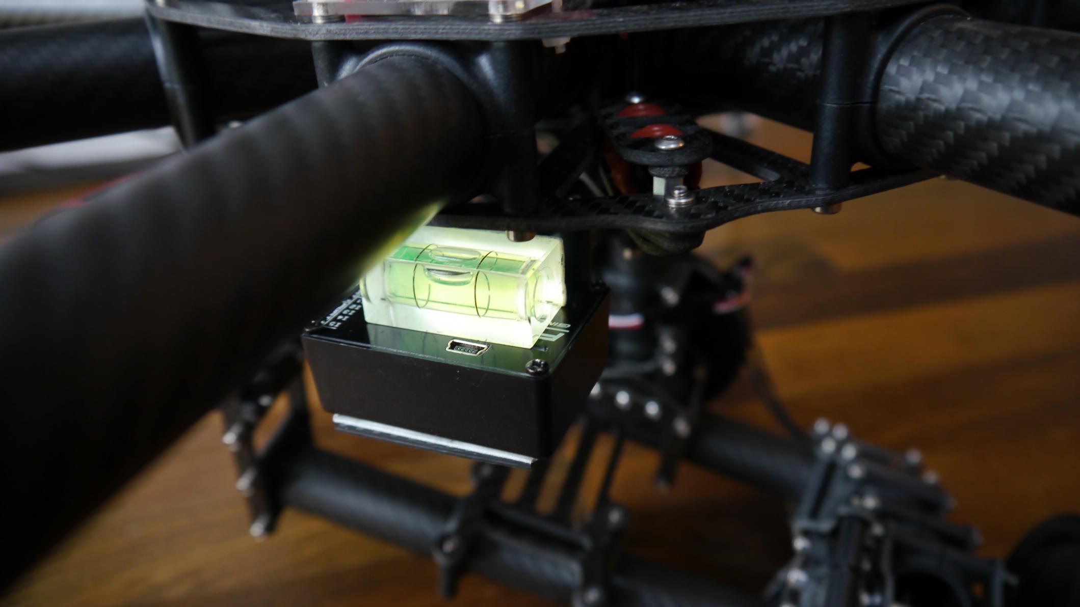

Okay picloc mounted like on the fotos: On the cam their are hardly any vibs to be seen since the isolation mount. Picloc simplest setup just the proportional values configured everything else is at default or 0.
Results before take off, same in flight than no difference :
View attachment 2997 View attachment 2998
Anybody a clue what might be going on ? Tried IMU filter etc no change. ACC calibrated on mount or on dead flat surface no change. Worked before every since HD 55 or like said i am not so sure since some time this issue. I couldnt find a older FW on the page or FW directory. Would like to try 53 again.
Boris
The vibrations on the Iphone are from the prop being right over it. The whole thing done with no props no problem. Propbs 100% balanced etc.

I have the same problems. roll-axis is rolling out of horizon (typical to the side where the picloc is sticked), Tilt is nicking up and down. both slowly after takeoff. And the won't go back to "normal" after a minute or so.
Dryrun at home is fine. Roll and Tilt are staying in position. is it maybe, because the picloc moves under the downwash during pan/yaw? is the air-presure of the downwash resulting in a drift of Roll and Tilt? The Props are not complete over the picloc, but the fingertips are.
View attachment 3002 View attachment 3003
(pictures are from below looking up)
Just in Case of vibrations, i tried an other flight without Acc (zero), but the same effect.
what is the problem? can anyone give me an idea?

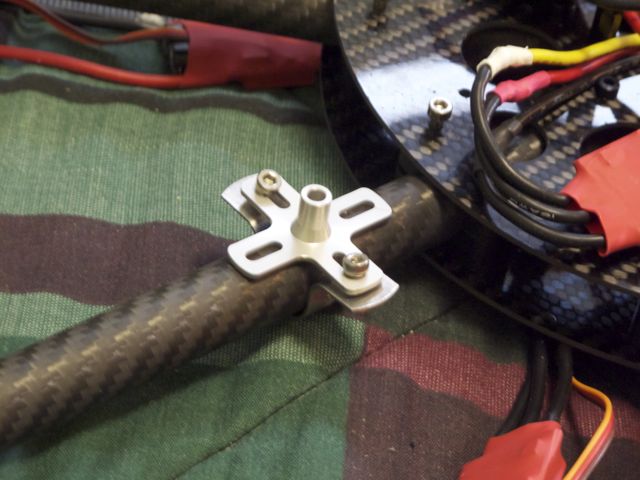

i have picloc installed on the pipe where the camera is mounted (beside my FS100 with arrow in tilt direction). this won't go with a DSLR... i use the cinestar 3 axis gimbal.
i know that the servos are proportional but it works for me... i had it the same way on my AV200.
