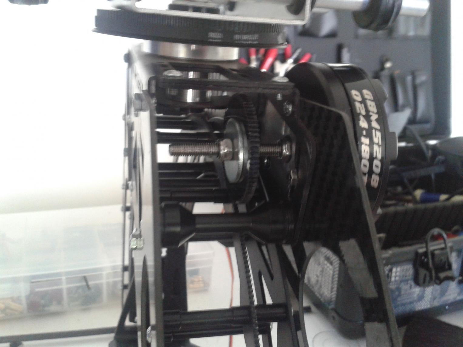

Hello I have some ideas of changing the servants of the pitch and roll of my AV200 for bruseless engines, it would be viable? Algem already tried that?
In pich imagine that works well, it would be direct on motor without engrenages or belts, my question is the feasibility of using the roll with the current gear.
Follows the idea photo

have not tested anything, it's just an idea, the motors thinking of using the pich iPower GBM5108-120T and on roll iPower GBM5206-150T.

Hey. I had the same idea, but alexmos told me, we could get trouble with the the gear (roll). Have u found a solution? Greetz
Keep up ur great work.
I bought the motors and the parts needed to start tailoring, I am waiting to receive.
so it is with the motors will start working on it and post more photos.
I still have some doubts about how to put the motor in Roll.

good news, I finished the adaptations and made ​​the first test flight, there is still some tweaking but I liked the result.

Looks promising, I assume you used an Alexmos board for control?
I spent many hours trying to get that kind of result with servos and an RSGS and never really succeeded...

yes I used a alexmos board never get anything like that with servos, and will improve even after adjusting
