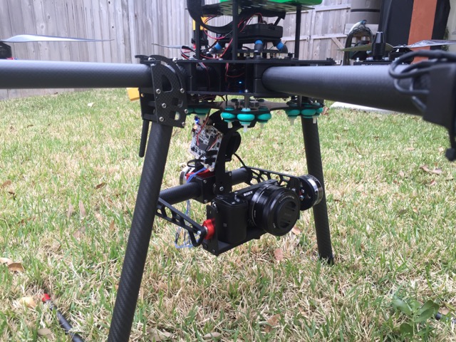

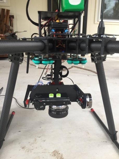

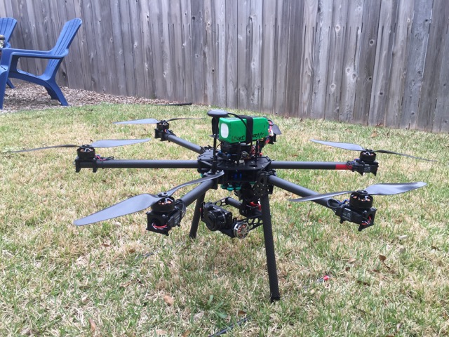

Finally got my quadframe V2 gimbal installed with the CP controller. I spent a lot of time balancing and I added some nylon bolts with nuts through the rubber dampers so that I could manually adjust the stiffness since the CP likes that. I just did an autotune and all seemed to go fairly well. Two issues I noticed:
1. I got some buzzing when manually pitching the copter back and forth. The Dampening P was at 1756 for Pitch and I took all the way down to 500 and still had some buzzing at an extreme tilt backwards. Doesn't matter if the camera is pointing forward or tilted straight down. I tried another autotune and no change.

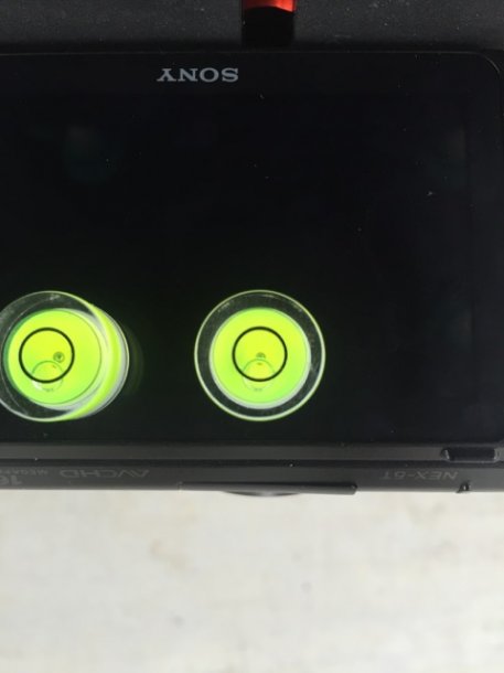

2. When I tilt the camera straight down via my transmitter it is not at a perfect nadir position. I tried messing with endpoint positions on my Taranis but that did nothing. I also tried adjusting the home position and it still didn't help. See bubble level pics below. How do I get it to point perfectly straight down. I will be using this for mapping and it is imperative.
I will be adding all my values to the spreadsheet in the next couple of days.
thanks!

I can tilt/pitch it down via the transmitter control and no problem (except its not perfectly straight down). It's when I pick up the copter and move it around as if it were pitching/rolling in flight, when I have the nose up to say 30 degrees is when it starts buzzing/vibrating and it goes into recovery mode.
Curious to see how mine does in the air too.
