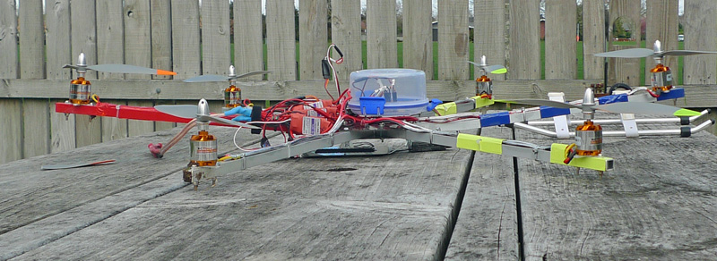

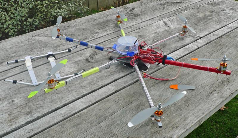

View attachment 769View attachment 770

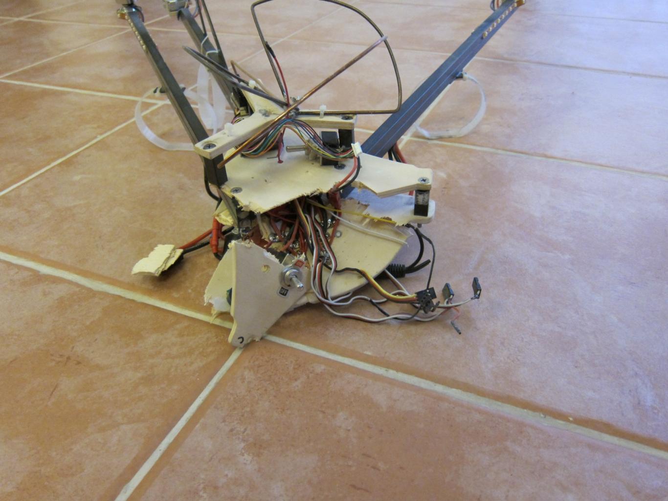

I broke it
After 2:30 of flying with the CC board and fitting an altimeter this morning, I broke it for the first time :(
At a 200' hover above my park, Motor 4 (south-west) started spluttering / lost power and down she came sideways really quickly. I reduced power and with lots of left-stick at 20', I tried to slow it down... not that successfully and she hit the ground...
Damage: Front and rear ali arms bent upwards (reshaped over my knee).
Rear prop lost a blade.
Trex-700 u/c bent - damn, don't have a spare.
Diagnosis: Me (technician by trade) appeared to have performed a sub-standard solder job at the motor end as one wire (while looking good under the shrink) pulled apart really easy while stripping it. Duh
Now re-tested without the u/c. It is about to be rebuilt as Mk3 so a bit more care will be taken.
