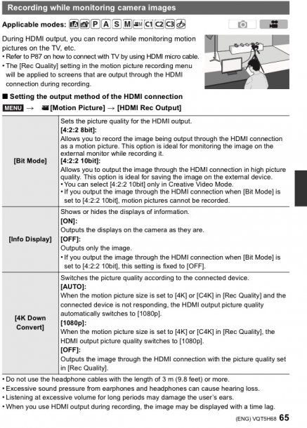

have you tried tapping the LVF button a few times?
and here is the relevant manual page.
it works for me with my el cheapo $10 chinese HDMI converter in all modes including UHD and 4K
