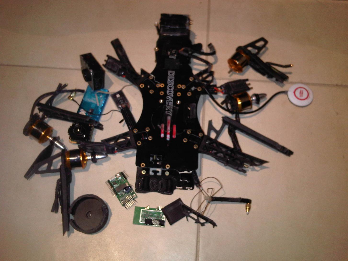

Oohhh Explain this one?!
SMP
Roughly 25 flights no issues, 5 flights that day no issues. Waited for GPS lock and Home Position Record prior to takeoff. You can see it go into GPS mode and then roll to the left, motors go nuts trying to level... Naza Fail, ESC Fail?? Unresponsive to Atti/GPS/Manual, didn't get a chance for a fail safe but suspect that would have been unresponsive as well. Wobbled a bit but never rolled over, went into a steep fast dive into the only piece of concrete in the bloody desert... Couldnt see it hit but even at 200 yards away, heard it!!! Went nose first into the black and exploded everything nose to tail. Rippppppppped out Antenna mounts!!! Boards etc!! . Naza is the only thing that is intact (figures) ..dont really want to conjecture if it survived and the gps which did have a 3D Puck saved it!! Again intact may not mean it survived the impact. Micro SD was ejected 15feet away from gopro!! Sadly SD was corrupted but managed to recover up to the start of the fail sequence.
Uhoh... Heres where it starts!
http://youtu.be/oPVY3yB4iRM
The not so surprising conclusion.
Lanzar
Well the motor is overspining in video. And you can also hear this in our video. Hard to say what went on. Sorry for your loss.
tombrown1
It looks like you were starting to right it just as the video ended. Sorry it turned out that way. If ATTI and Manual both failed I would think it would be some sort of motor or ESC failure.
Good luck getting up and running again.
TB
Dewster
I think one of the props came loose and resulted in loss of thrust. That's the only thing I can image would cause the motor to spin like that without providing enough lift on the failing arm.
Electro 2
Loose prop, no question. You checked prop nut torque before the flight ?? I always do, especially the counter-rotating ones which are more prone to backing off. Some guys Locktite 'em, makes it a pain to change props, but no back-off issues.
SMP
Hi guys, thanks for all the suggestions! had a couple of good heads up about Electrical Activity but starting to think most likely culprit was prop starting to come slightly loose and slipping. Upon picking up motor debris was able to pull a prop nut off by hand, granted it was bent at a 30 degree angle and took some force but still should have been tight... Was running the Sunnysky motors with the stock adapters and had these on order http://www.hobbyking.com/hobbyking/store/uh_viewItem.asp?idProduct=19586 but didnt want to wait. As Electro said, the prop check should have been done. Ironically or predictably, while we do this for all our larger birds this was the last battery of the day and we neglected to check. Pilot error pure and simple. No worries, gravity wins, build another :)
What we HAVE learned over a couple of mishaps is that when it goes wrong you have very little time to make the correct decisions. If they aren't either a habit or top of mind it's unlikely you'll get a chance to try everything you should have. And you'll spend hours going over should have, could have scenarios.
First thing we've committed to is a no tolerance preflight policy. Prop Rotations reconfirmed, Prop Tightness reconfirmed, Batteries secured tightly and Battery Connections secured with electrical tape and no dangling balance connectors. Point the bird into the Wind. When the bird is powered up all motors start together or restart. Since we're DJi NAZA/Wook - Wait for full GPS lock and Home Point Record (takes longer than we expect and like to wait). We then rerecord the Home Point manually. Upon liftoff, check control surfaces and gimbal controls work correctly, check Atti, Gps, then Manual. Flip back to Atti go fly.
What I'm NOW chanting in my head (and will say out load before every flight is) so that I can make it habit...
In the event of any failure - Raise radio and point RC Ant straight up - flip high HiPower on UHF- Atti to GPS to Manual, to full throttle, to IOC Home, to Fail. If I cant catch it at that point at least i'll feel like I gave it a fighting shot.
On this last one - I only made it to Full throttle. Dont think IOC or Fail would have helped but now will never know. Again, Pilot Error :dejection:
Anyways, thanks for the help all!!!
