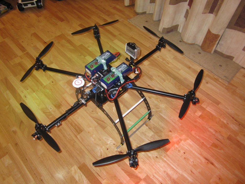

Sorry about your crash RT, seems all av130 bends the same way in crashes hehe)
Btw, as for hex redunancy - I had few precedents with burned in the air esc's on the flat mk hex, it did not flip and remained in the air on five engines, although it is not an easy task to land it ..
