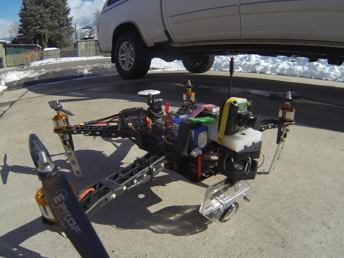

I think any board camera will fit on the disco. One thing to understand with that ship is you'll be limited to the size battery you can squeeze into the batt bay, I could barely fit a 4000mh zippy c in there and even then, it was tail heavy. I guess you could strap your batt on the top plate if you were so inclined.

I'm probably not the guy to ask, I only had it because it was a matter of convenience. A member here (kloner) had one that shorted out and so I bought the frame plates from him, already had arms from an old 450. I like the more classic style quad, they just seem to suit my old man style of flying, plus I don't care for the plastic dji arms, they're wiggly. I cut the front off to fit a different kind of gopro mount-
The frame and motors/prop setup is probably gonna go up for sale soon since I don't need them anymore. Look up Kloner's disco build log he has here, he's the disco king.
