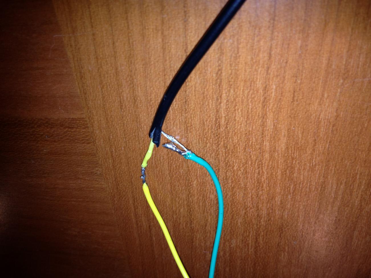

Ok so out of the gopro there is a yellow wire for video, and a red and white for audio (which i am not using). wrapped around the yellow video wire out of the gopro is a ground wire. Here is a photo of the yellow wire wrapped in a ground wire, the ground wire from the gopro is soldered to a green wire that carries it to the transmitter. Again the "no video" message is from the monitor and is the same message it gives when the source was turned off or unplugged. Thanks for your help.

ok, the shield is what your calling wrapped, sorry. i'd peel that black cover back a little further and make sure there isn't a short where the wires melt the plastic from soldering. i see it on the yellow wire, melted it pretty good. if that's for sure not shorting, just make sure the yellow wire is the 2nd flat on the plug in front of the plastic grip. A volt meter, thing that shows volts in numbers has a beep mode where you touch the tips and it beeps. put one on one wire, other on another and if it is the same, it beeps....... continuity test. I can sit here and tell ya, yea looks great, but without knowing where they all are on the plug can't absolutely rule out it's not the yellow wire. I've bought 6 of these go pro plugs from readymade and every single time the wire and the plug don't correspond to normal a/v color coding
If you can confirm which pins are connected to the yellow/shield you have there and still no worky, i'd want to see where any other connections you made or where the wires go into the vtx....... it all has an antenna connected i hope... never fire this thing up without one. show me anything else there is so we cn go over it all.
just so i asked, that shield and the green are soldered really well right? it's not just that little blob touching a tiny piece of the shield wire? the pic is a weird angle...... gotta make sure

one other thing before anything else,,,,, pull the plug from the go pro, push it back in,,,do it a few times just to make sure it's going all the way in. Get me a pic of the plug in the cam too if it doesn't work and we keep going

Well, today Kloner you can call me an moron. I was looking at the 5 pin backwards when soldering. So I thought I was looking at the ground being all the way to the right, but it was backwards so I was soldering a to the pin all the way to the left. Works now, thanks for helping me work through that.
