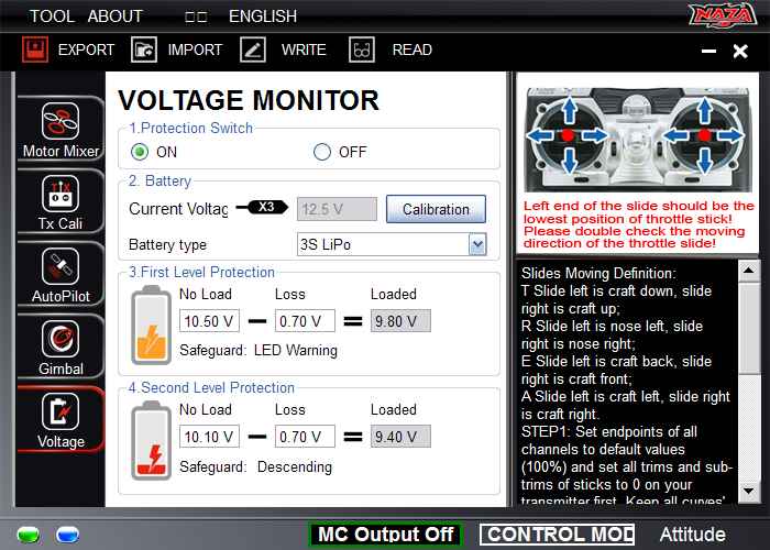

Wondering if anyone could help me out with the values for my battery?
I have no idea what the correct input must be?
I'm using a 3s 4000 battery

Dean
Here's how mine were set when I used 3S 4000 batteries.
Jack
Dean
Thanks Jack!
Just changed the batterie values,and i've flown it in my garage,at eye level is it normal to have propwash?
Cause it was a little wobbly?
I've got my values on:
135 135 135 130
90 90
