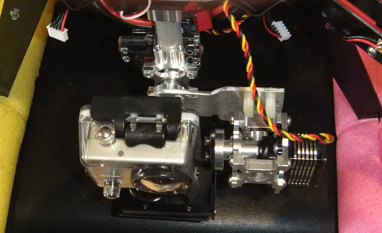

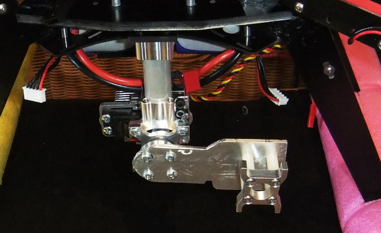

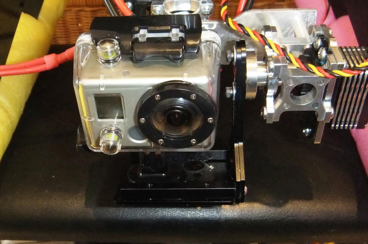

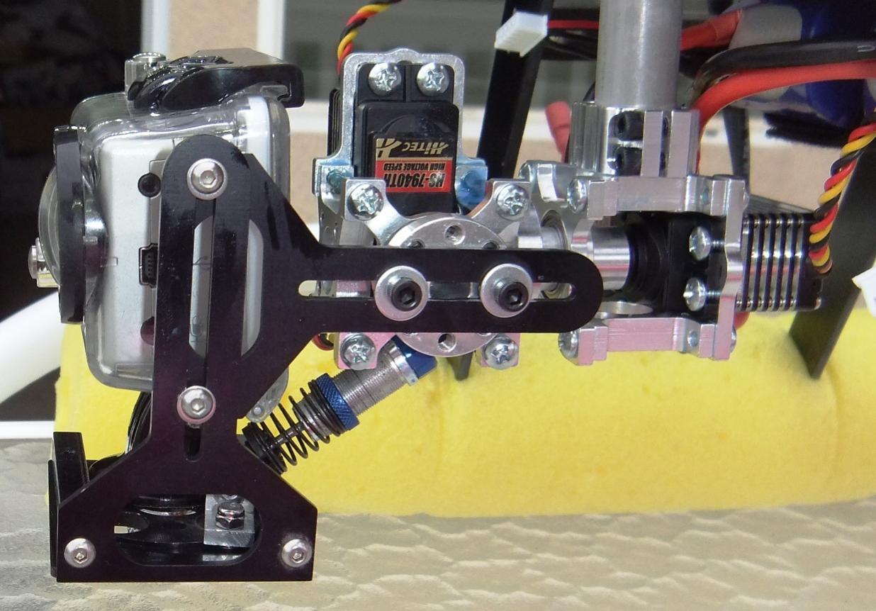

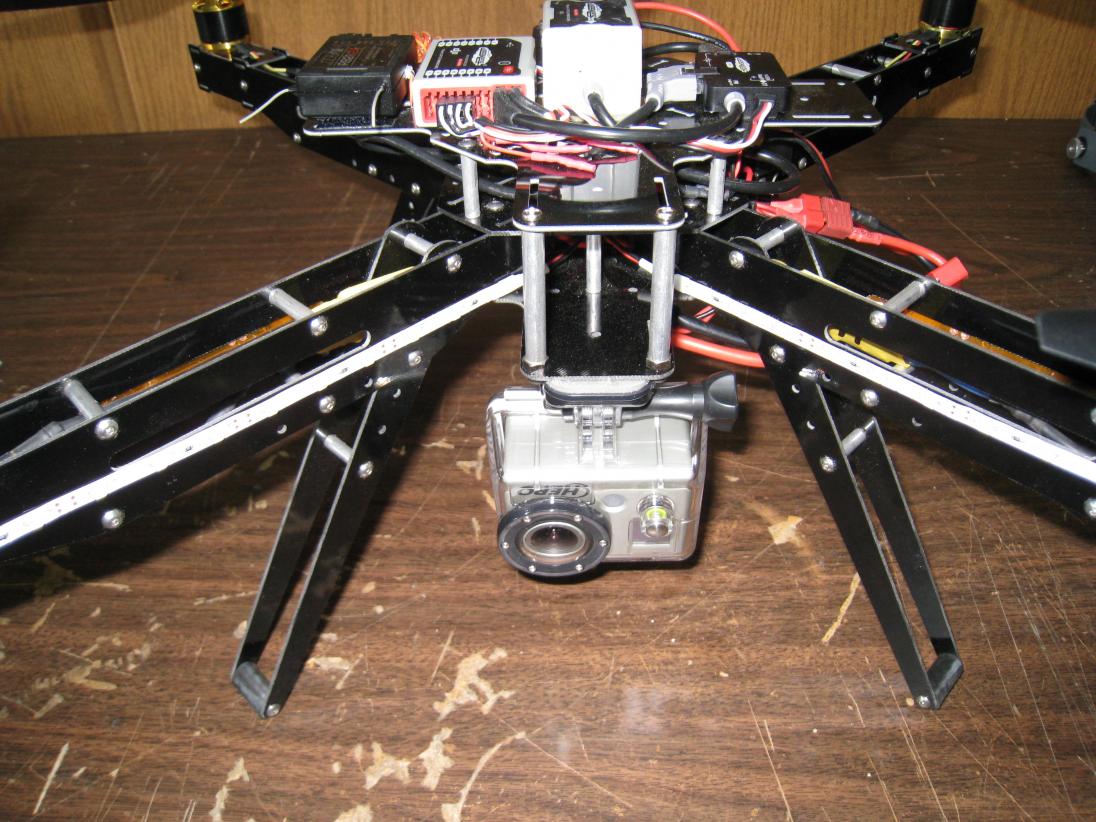

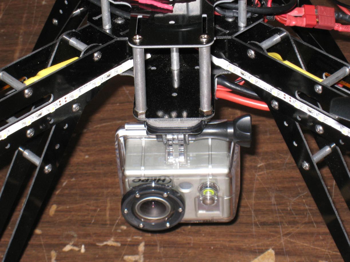

After deciding that my mkTR Pro setup was just a bit heavy for my 600-size X8, I decided to try an optimize the performance of a new mount for my GoPro2. Based on my previous testing, I knew that if I could get the angular ratio between the servo and the camera as close to 1:1 as possible, for both pitch and for roll, that would maximize the responsiveness of the mount to changes in the MC's gimbal outputs. To do this, however, I now also know that you need to use high speed and high resolution digital servos. Most of the newer higher-end servos now have 12-bit resolution. This is key, or you end up having a lot of "jitter", as the servo bounces around between two positions.
Anyway, I then started looking around for what I had in my "pile", that I could use, and found one of Andrey's mid-sized landing gear. This is the perfect size for my X8 and all I had to do was drill four new holes. This mount also has an isolated cross-member, with a tab sticking out the front. Next, at Andrey's suggestion, I checked out the new ServoBlocks that ServoCity.com now sells. These are very cool, and are very reasonably priced. Quite a clever design. :) Anyway, I ordered up a couple sets, along with with two of the tube clamps and a 2" piece of 5/8" tubing. I also ordered two Hitec HS-7940TH ultra-fast (.06s@7.4V...) titanium digital servos. These are normally quite expensive, at around $150 each, but ServoCity sells them at $119. Still pretty pricey, but the blocks are cheap enough that it is worth spending the "extra" money on really good servos. What I don't have to do is spend any money on a G10 or CF-based mount. The blocks are the mount. :)
The only other bits I needed were some pieces to actually mount the GoPro2, and its case. Again, I went back to my "junk" box, and found a bunch of parts left over from the Raptor electric conversion kits I used to sell, that ended up working pretty well.
Here's some pics:
Once I got it all setup, and had everything plugged into the MC, I found that because of the extra side load on the tilt servo, there was a bit of noise and high frequency jitter. I fixed this by adding a small RC car shock, which eliminates the loading on the servo. I was absolutely amazed that once I did that, there was exactly zero jitter, in either pitch or roll, and there's not even any noise. They are completely quiet, which is a good thing. :) Next, I hooked up the CastleLink, and reset the 10A BEC to 7.4V.
Here's a short test I did, before doing any "tweaking" of the gains, etc.:
All-in-all, I'm pretty pleased with how it is working. I need to get a Hitec servo programmer, so I can dial it in a bit better. I want to play with the speeds a bit and see if I can get the roll and tilt operation to match even closer.
Tomorrow, I'll also do a test flight, which will be the real acid test, but so far, the performance is quite good. I just checked, and my total bill from ServoCity was $490. Not bad when you consider the cost of a "quality" mount, like the popular AV-130. :) Also, I saved about 1/2 pound, over the mkTR Pro setup. That will make my motors a bit happier. :)
-- Gary

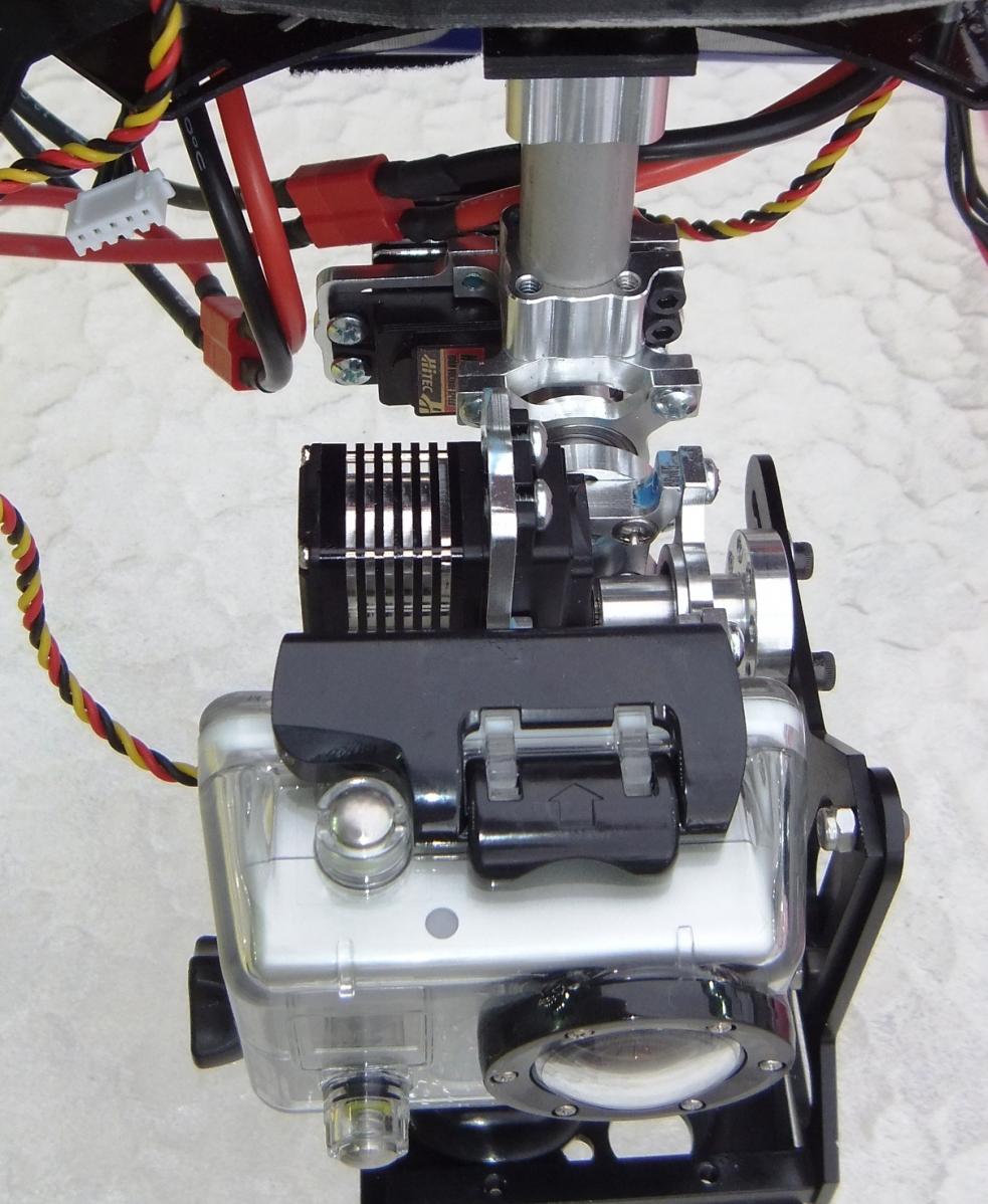

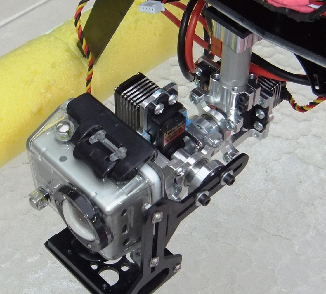

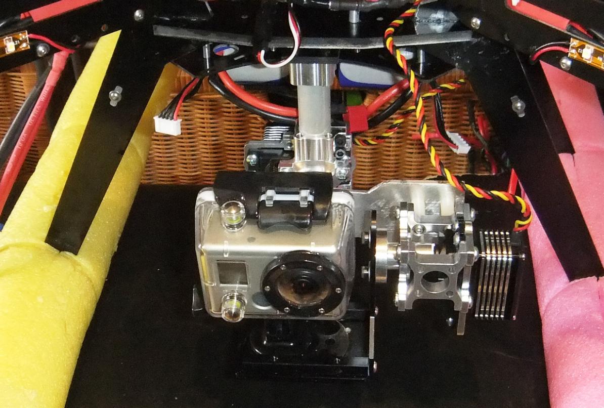

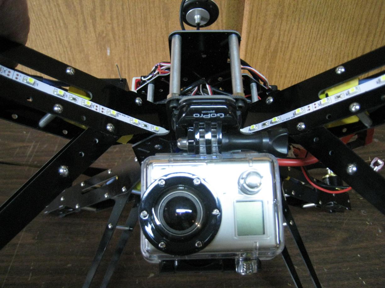

Sorry, Ed, I missed this. Anyway, I just finished a minor "redo", which is simpler, and geometrically more accurate. The first version worked fine, as long as the camera wasn't pointed down. When that happens, the roll axis becomes more of an arc. To correct this, the tilt axis should also be centered on the camera sensor, or focal plane. To accomplish this, I fabricated a plate that moves the tilt servo out to the right, and then standoffs are used to move it forward a bit, to allow the tilt range of motion.
The rest of the servo block assembly simply slides on and attaches with four screws.
This balances much better as well, and I was able to eliminate the RC car shock.
Operation is even smoother than the first version, with the camera staying fixed, even with large movements of the platform.
I'll have to wait until tomorrow to give it a test flight, but already, I can tell this is working better than the first version.
-- Gary

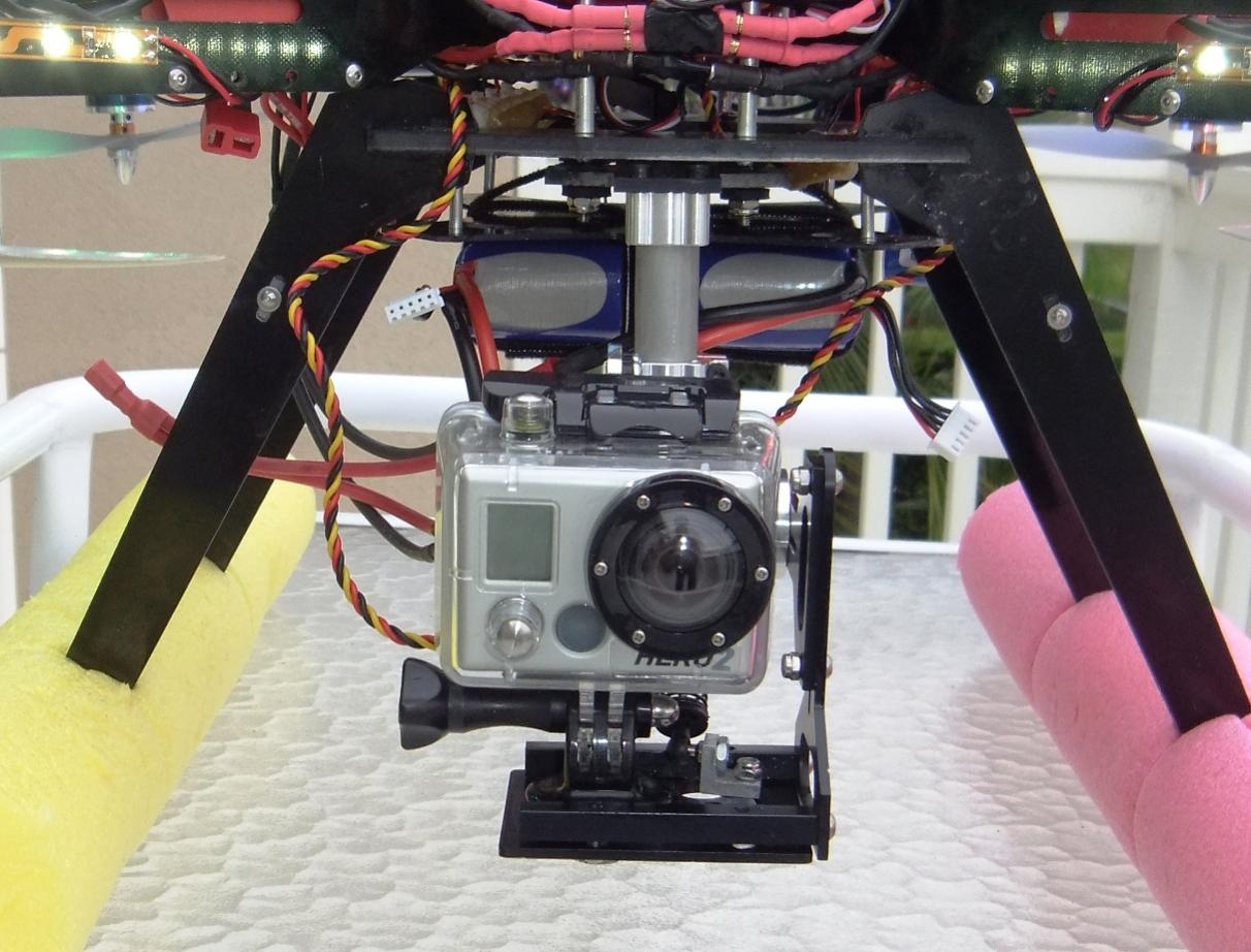

I've made a few more tweaks, mainly playing with the gains. One thing I did do to the mount itself was double up and use two of the old Raptor CCPM plates I'm using as part of the L-shaped mount off the tilt servo. This makes the camera mounting more rigid, and less susceptible to vibrations.
I started playing with the gains as well, and found that with a 1:1 ratio this sort of "direct drive" has, the gimbal gains need to be dialed down from the "standard" value of 20. At that value, the servo over-corrects. I ended up setting both tilt and roll values to 17, and it seems to be pretty close. Geared, or belt-driven mounts need to have higher values, based on how much of a ratio change the belt/gear drive induces.
Here's my latest test video:
This concept works pretty well, with a small, compact and fairly light camera, such as a GoPro/GoPro2, but I don't think this would scale up to something larger. I'm thinking would work well for a larger setup is having a belt drive in each axis, but probably no more than about 1.5:1 reduction (to minimize the speed hit..), and then still use blazingly fast, high-resolution digital servos.
-- Gary

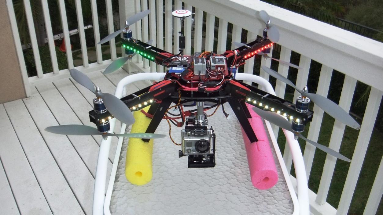

Okay, I finally got my act together, in the daylight hours, and managed a quick test flight. :) The mount works quite well. I do see, however, that I have a basic vibration issue, which shows up as a typical "jelly roll" in the video. This is being caused, I'm sure, because after my first "drop-from-the-sky" episode, I ended up with three of the props with nicks in them, so they certainly aren't balanced anymore. :shame: I have some brand new Graupner 11 x 5s, to go on here, but I wanted to wait until I had all the power issues sorted out. I thought I was there, but in today's flight, it turns out only one of my two 4s-3300 packs were being used. The packs, which i got at my LHS, came with Deans, and I got lazy, and didn't change them out. :shame: That will change before the next flight.
Anyway, the mount did its job quite well. I didn't really yank it around too much, mainly as I was also trying to test the voltage monitoring function, so I didn't want to stray too far. With only half the capacity I was expecting, I'm glad I stayed close.
I'm editing the video right now, and I'll post it a bit later. I'm doing two versions in the same video, one "raw" and one that has stabilization applied, to see if it will clear up the jelly roll.
-- Gary
