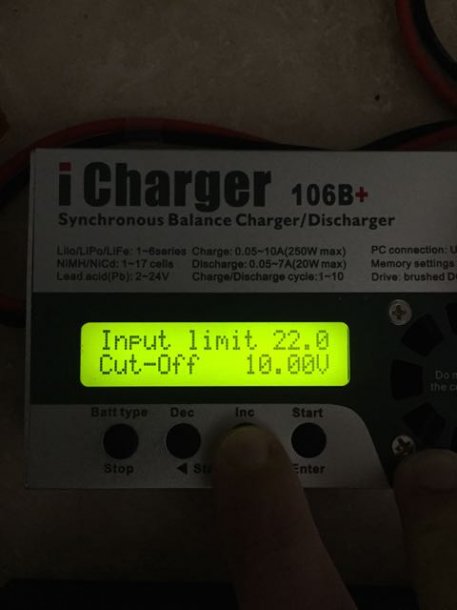

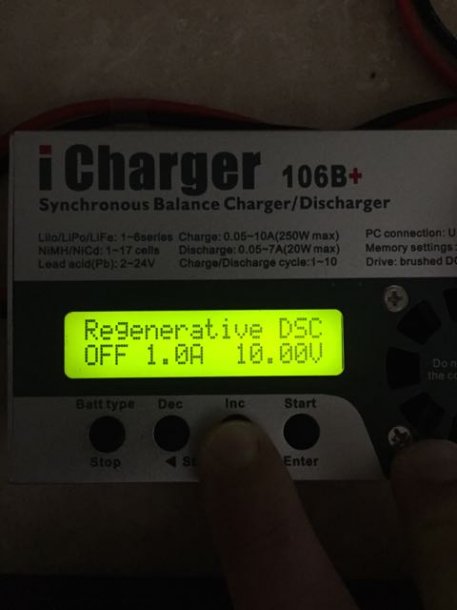

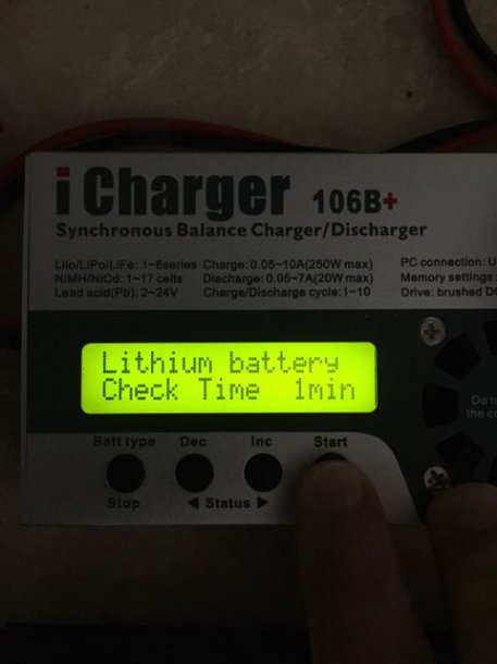

All,

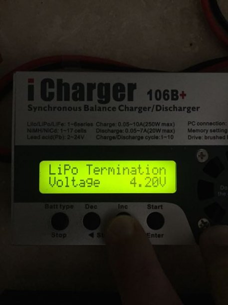

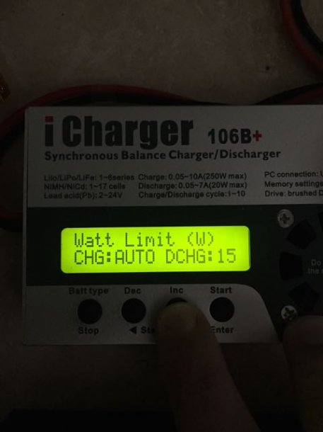

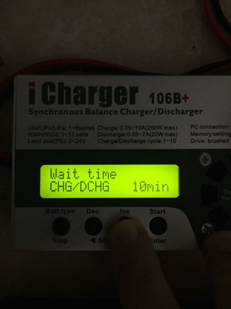

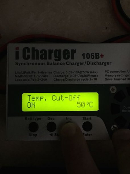

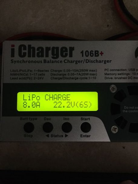

I have a brand new iCharger106B+ that terminates after 3:01 minutes and between ~300-400mah in. This is when trying to charge any Lipo battery. I bought this to charge my new multistar 6S 8000mah batteries. I have attached some pics of my settings. I have plenty of experience with chargers and I am lost at what it could be. Any help appreciated.

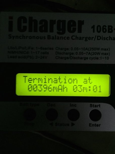

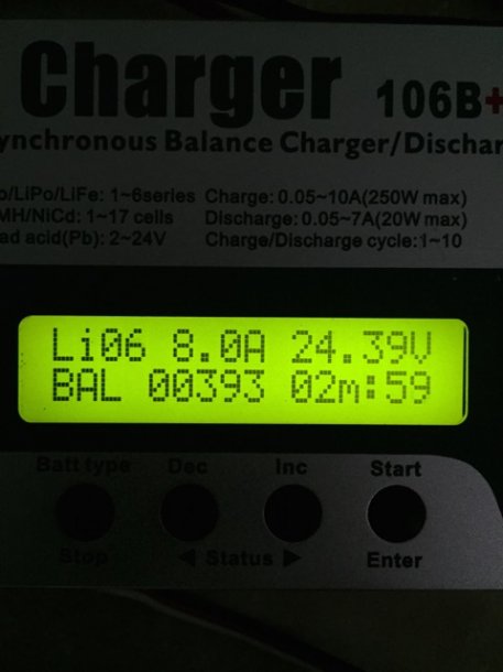

Here is a pic of the screen showing voltage/amperage just before it shuts off at 3:01 minutes. It gives no error message. I monitored input amperage and voltage and they were stable the entire time.
Measured cell voltage after disconnect from charger is: #1- 3.98, #2- 3.96, #3- 3.94, #4- 3.95, #5- 3.96, #6-3.96
View attachment 23611 View attachment 23612

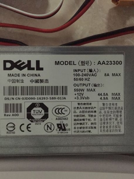

It's a Dell power supply, see pic below of specs.
Just tried a number of things. First, I hooked my two Turnigy chargers to the power supply and set one to charge the 6S 8000mah and the other to charge a 4S 5800mah. Fired them both up and they work fine (ran them for 15 minutes), drawing about 6.6amps between the two of them. Next, I hooked up just the iCharger and tried balance, charge, and fast charge with the same two batteries using 1C amps in and both stopped at the 3m:01 point. I then tried both at just 4amp, 2amp, and 1amp. Same thing, termination at 3m:01. Using the iCharger I again monitored the output of the power supply and it was stable.
