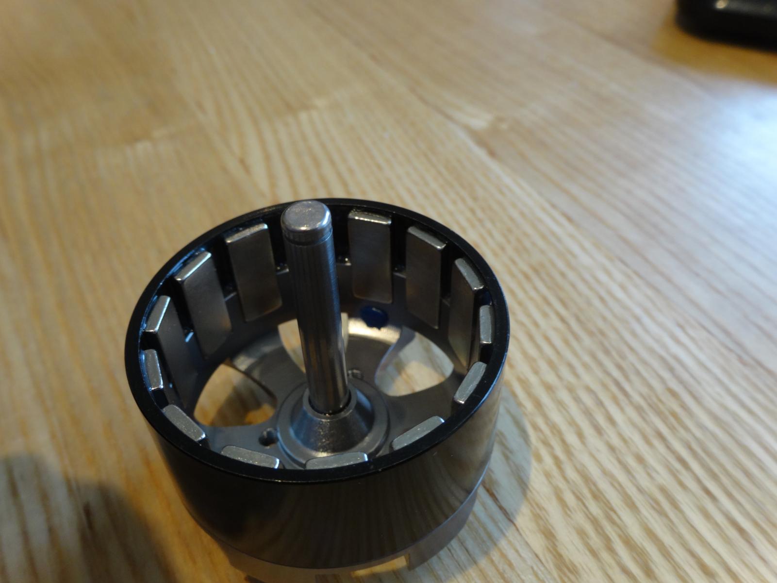

Dont believe this, spent last night setting up my radio, and all seems to go well.
This morning started to get ready for my maiden flight, so started to put the prop adapter bolts on, the top parts of the motor that hold the props on.
Put the 3 bolts on, and tightened them up no problems.
Came to my 5th motor, put the 3 bolts in, and tried tightening them..no way, it wouldn't tighten down on the first bolt so tried the 2nd same thing, ad the 3rd :(
Must have been a dodgy tap on thet motor as the other 5 there was no problems at all.
So Im going to have to break down again to change the motor.
Anyone else experienced anything like this, lesson learned build the motors up completely before building machine, especially anything to do with tapped holes.#
There's no way just to take the top part of the motor off is there, to replace it and save me stripping everything down again?
Its Tiger motor MT3515-15 kv400
rotorvista
to remove the top of the motor undo the circlip on the bottom and remove the washer and the motor will pull apart.
Maverick
It will need a fair bit of force to pull the can off, as the force of the magnets inside will be holding it. Don't lose the circlip... You'll probably have to buy a whole motor - don't think you could buy the can separately...?
Quinton
You may have just saved me a full breakdown, the circlip isnt the easiest to get off as it had no holes to fit into.
I took apart a spare one I had, and noticed what looks like glue or threadlocker inside as a blob, what would that be used for to balance it?
I will be using Xoar 15x5 props first then the Carbon Fibre Tiger Props (same size) to compare the difference.
Quinton
You mean the circlip that went flying across the room into the cats litter tray :)
It was a spare motor I took apart, and my dealer where I purchased the motor from just told me to send it back to him.
I will be able to actually get it out without stripping down, by just taking the bottom things off and unscrewing the 2nd top plate..not something I wanted to do at this stage, but its maybe best.
The magnets weren't actually that strong
