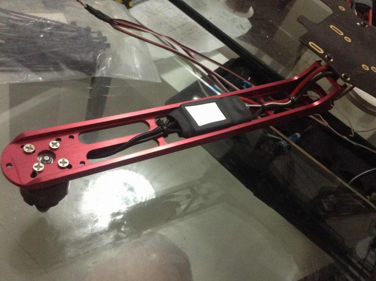

Hey guys, I am new here, but I wanted to detail my upgrade to the aimdroix arms for the F550 Flamewheel. I just received my set today, and will be posting pics as I rebuild her over the weekend. Two things that I noticed that I wish I had known from the get-go.. 1- Buy an extra set of screws. The screws that were used to install the original arms and mount the two center plates can get stripped pretty easily, even without over torquing. I am going to attempt this build using my old set , but I wish I had ordered a new set. the bad screws that give me trouble will be replaced later, and I may have enough extra screws as the original kit came with a few extras. 2- be prepared to lengthen the power connections to the esc.... the new arms are around 50mm longer than the original arms, and there just isnt enough esc wiring to reach stock. I am going to kill 2 birds with one stone by installing a male dean connector to each piece on the power distribution plate, and a female on each esc as I have hundreds of deans connectors handy.
Besides these two things, it seems pretty straight forward. The arms are very sturdy, very cool to touch as they are Aluminum and they noticeably do dissipate heat. I bench tested one earlier, and the motor stayed pretty cool. Another thing, I originally wanted to replace one arm at a time, but this is not possible because I will need room to solder the deans connectors I spoke about earlier. It could be done, but might as well get all of the soldering done at one time instead of leaving an iron hot while you do everything individually to each arm. I will post pics here of the progress I make in the morning. Fell free to ask any questions, and I will do my best to answer them before you guys have to buy a set of your own.

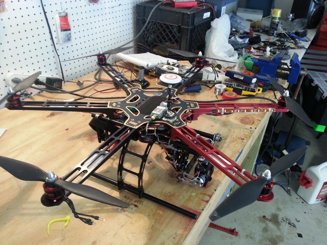

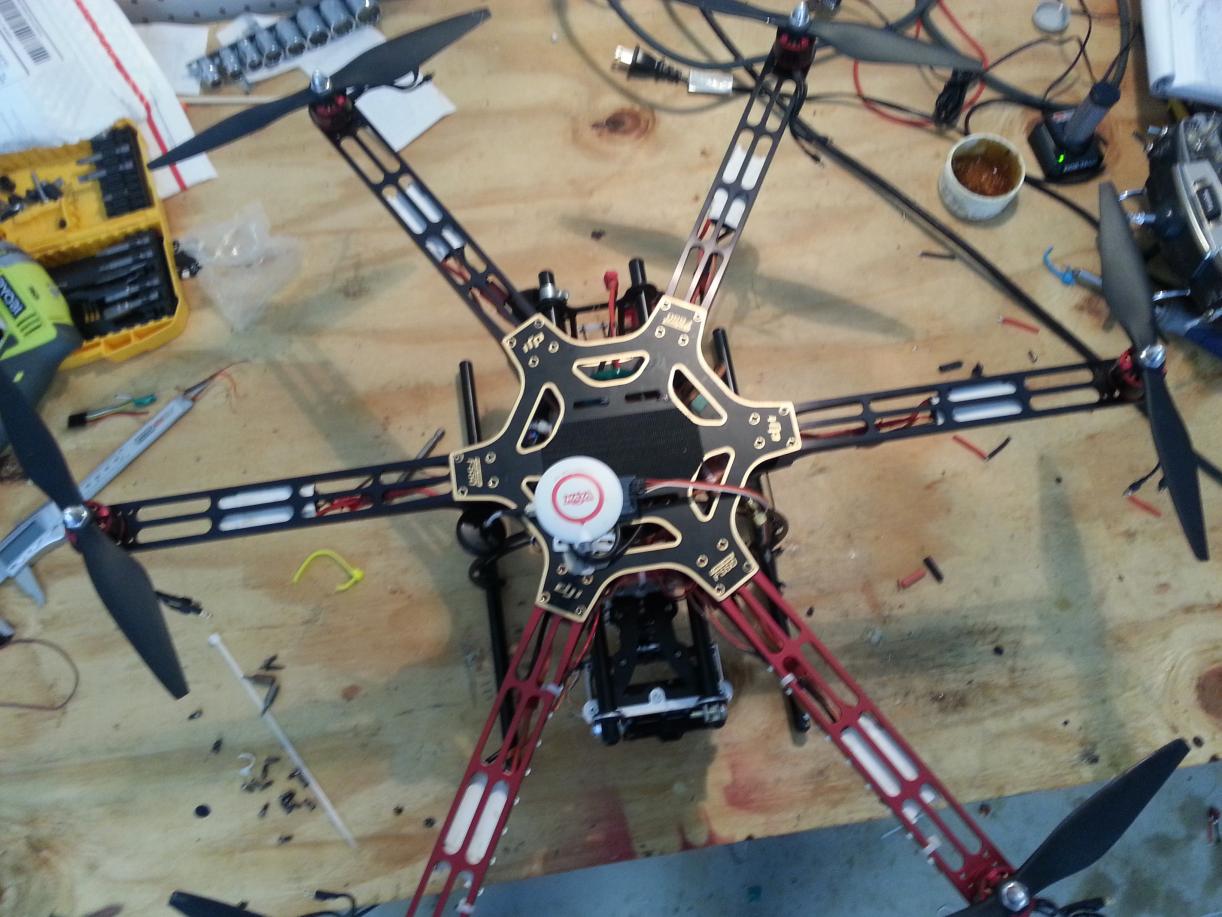

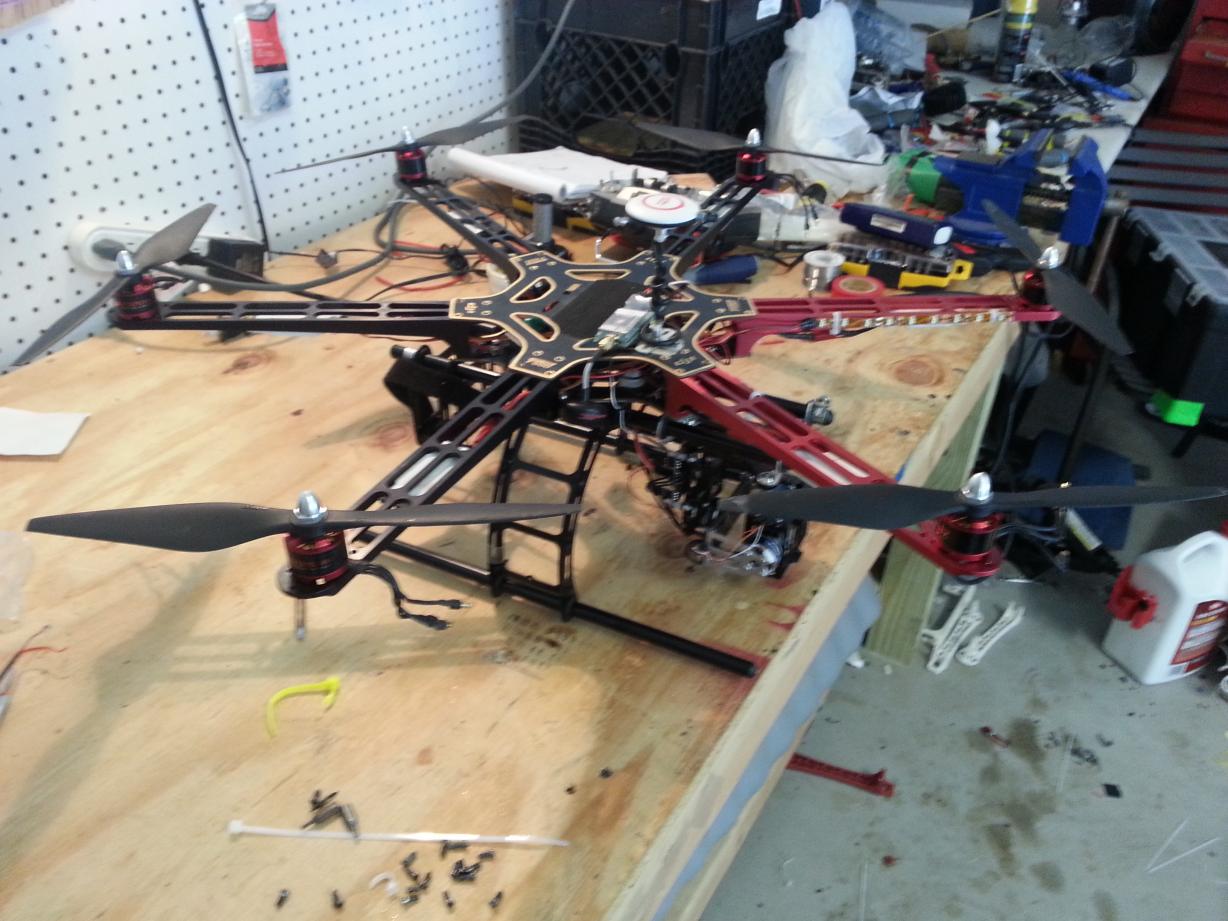

I intalled the arms, only I messed the bearings up in a few of the dji stock motors. This happened becaust of the screws that came with the DJI frame...i used them on the original arms and discarded the ones that came in the dji motor packs...dji frame screws have a recess piece that goes in to the aluminum to far and thus went too far in to the motors...i took this as an opportunity to upgrade motors...in the mean time, I placed my stock dji motors on just to show you how much room is created. here are a few pics..
I also had to extend the esc power connections because the new arms are longer than the original causing a gap between motor and esc. When you build yours, add 2 inches in the form of deans connectors...this way you kill 2 birds with one stone, making it easy to swap out esc's if needed.
View attachment 13735View attachment 13736View attachment 13737
