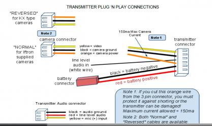

This is my 2nd time around buying FPV gear. I would consider myself an accomplished solderer and relatively meticulous. With that said I recently purchased an ImmersionRC diversity Rx in 5.8Ghz. I also got an Iftron Stinger Pro 250mw 5.8 tx. I was told by a few people there is no issue with them working together. So all the lights go on normally, no smoke, antennas are all plugged in, channels have been flipped through numerous times. I've tried various other video sources and also plugged them directly into my monitor to make sure everything is working. So the issue is definitely in the transmission of the video. The Tx ( most probable place for failure) has 2 connectors, a 3 pin and a 6 pin. the 3 is for audio only so I am not even connecting that one.
The 6 pin has :
black/red for input power.
yellow for signal (soldered to center tap of RCA plug)
black for video signal ground (soldered to RCA coax ground)
orange for camera powere ( taped off as not needed with camera)
white for audio gain(NA)
Did I do something wrong here? Would the lights go on if it were defective at all? My last setup I did the same and it fired up pretty quickly but I never soldered or used any RCA's as the camera was a small sony 555 that wired directly into the tx.
