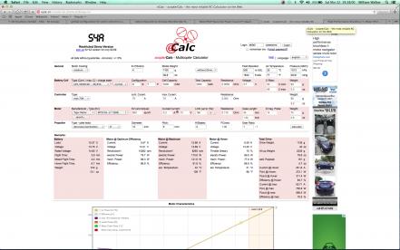

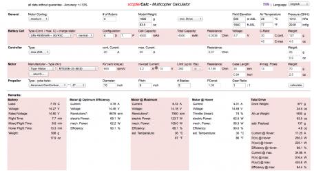

Im confused on the incln. drive and without drive....
Please let me know if this will work on my set up. In model weight i put it at 1100g for gimbal and batts with frame. I put T-Motor MT2216 800kv as the motors.

AUW =2500 grams, 1000grams = 2.2 lbs. Drive included. Assuming you paid for ecalc, your motors are listed towards the bottom of the Tiger Motor list. There is no free version, so the list of motors and batteries are incomplete and vary every time you log in.
Hope this helps,
Lee

See this is what i thought i had before but i guess not..... Now I'm totally confused. (Paid for full version)
frame weight is 600g
gimbal is 200g with out cam and probably be 350g with cam
I am using Q brain 25a x 4 for the ESC
Really feel back at one with this hobby/field.... :(
Every time i choose "incl. drive" it fails .....

You said the MR weight 5.5 lbs. This where I got the 2500 gms from. You need to find a good scale and come up with an accurate weight. I use a 5kg gram scale. AUW is total weight with batteries. Leave the drive included box checked. If your trying to calculate based on individual weight of the components, from my experience the MR will always be heavier. Stepping on the bathroom scale doesn't work either. If you don't have a scale, go down to your local UPS / FedEx store and see if they will weigh it for you. Without knowing what it weighs this is an exercise in futility.
