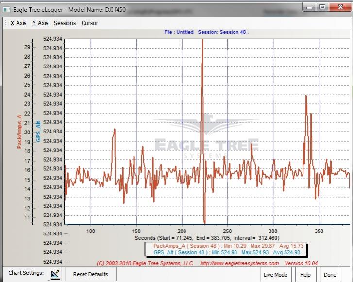

heres a log of said combo in amps, that's split up between 4 30 amp esc's and 4x 350 watt motors.
