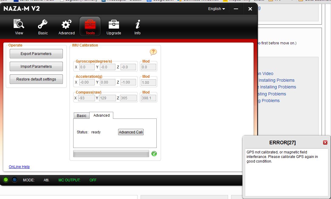

I built a quadframes hex with the dji naza with gps. the hex flys well but i keep getting an error in the control software on the gps.
I cannot calibrate the gps. i do the advanced calibration and it keeps giving me the error below.
"gps not calibrated, or magnetic field interferance, Please calibrate gps again in good condition"
I have tried to calibrate in diffrent places in different conditions, same error
anyone with suggestions?
thanks
OneStopRC
Dirty Little Hucker
GPS calibration issues can come from weird sources, watches, cell phones, electrical towers and some or most steel build buildings. Get it out and away from anything, remove rings, bracelets and watches and do the GPS dance. If you're unsure of the GPS dance, you probably have not done it and I recommend you read up on the GPS calibration part in the manual. You can also find some very good videos on youtube explaining GPS calibration and how to set your declination.
leapnlarry
Thanks for the replies, I couldn't get the GPS into calibrate mode because of the error, I ended p degaussing the GPS with a magnet to get the mod number from 250 to 600. After that the error went away and it flys perfect in GPS atti.
