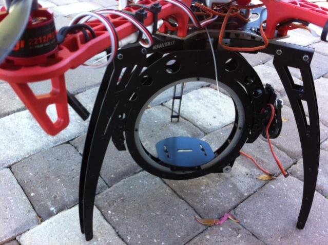

I am trying to get my 2 axis gimbal to operate correctly. I am controlling it with a DJI Naza. I am using the F1 and F2 outputs to control the pitch and roll. The problem is the servos do not stop once they get going in a particular direction. If I tilt the copter sideways, the gimbal will start rotating to correct for the motion, but rather than just correct, it continues to rotate until I tilt the copter in the opposite direction. same is true for the pitch. Also, I have the manual pitch adjustment controlled by my VR dial on my Futaba 8J radio. Rather than just move the gimbal pitch incrementally based on the dial motion, it initiates motion in the direction of the dial. If I move the dial slightly, the gimbal goes in that direction, but rather than move a bit and stop, it just keeps going until i turn the dial in the opposite direction.
I have tried different end point and gain values in the setup software with no success. I am using 360 degree servos. Is the flight controller expecting standard fixed rotation servos, and outputting a constant value for the set point? Is there any way to fix this problem in the NAZA setup software interface? Thanks.

I think I am on the right track, now. Standard servos have a potentiometer built in. A standard servo can be hacked into a 360 degree servo by going inside and replacing the pot with two resistors. So, in a sense, I am reverse hacking the servo and putting the pot back in. Instead of putting the pot inside the servo, I am going to place it outside the servo and on each of the pitch and roll axises. That should tell the NAZA what it needs to know to stabilize the gimbal. It will tell the servo to turn until the potentiometer tells the NAZA that the gimbal is stable and to stop turning. That is my thought process, anyway.
